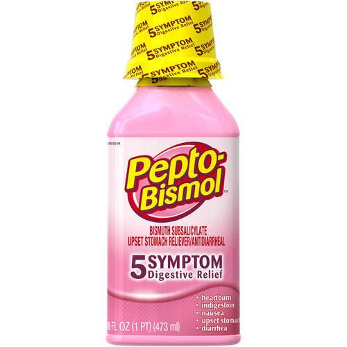

Why does everybody have the jeebs about bismuth all of a sudden? I'll bet a lot of people have this in their medicine cabinet:
For years, bismuth minded its own business. Now, everybody's all up in bismuth's business about being radioactive or toxic. Its toxicity is quite low for being a heavy metal:
https://en.wikipedia.org/wiki/Bismuth
Fun fact: bismuth expands when it freezes, like water does.

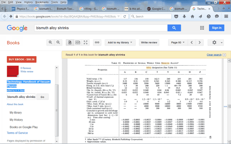

There are several aloys of bismuth and tin that have interesting properties. One where when the metal freezes (solidifies) it first shrinks then over a period of hours expands to the size of the mold. It was once used to examine rifling. I think it's amazing.
This isn't exactly the alloy I was thinking of but it has similar properties first shrinking after solidifying then over the course of hours expanding.
42.5% Bi
37.7% Pb
11.3% Sn
8.5% Cd
This came from google books
Technology: Handbook of Vacuum Physics
edited by A. H. Beck
