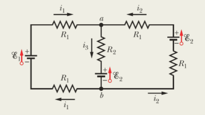

This was the given problem. In the diagram, one can see that the current flowing into each battery equals the current flowing out of each battery. Is this always the case, and why?
If there was only one battery, I guess it could be considered conservation of charge, but for eg the battery on the left, why can't 2A flow out and 1A flow in?

Suppose, as you propose, that for the battery on the left we have 2A flow out and 1A flow in.
After 1 second of time in this situation, this battery would have sent out 1 Coulomb more charge than what it had received. Conservation of charge should tell you that this battery would then have acquired a net charge of ##-\,1## Coulomb. Do you see a problem with that ?

Hi @laser. In addition to what's already been said, I wonder if the ambiguous meaning of 'charge' is causing any confusion. Just in case...
A battery does not store charge. A battery has zero electrical (+ or -) charge.
In normal use, we say a battery ‘discharges’. That means it converts its chemical energy to electrical energy. It’s supply of chemical energy is reducing.
Current-in = current-out. Always. (Think of a pump, pumping water around a heating system’s circuit: rate of water in = rate of water out.)
When we ‘charge’ a (rechargeable) battery, we’re not giving it any additional charge. We’re running a current through the battery ’backwards’. This converts electrical energy back to chemical energy inside the battery. That’s what’s meant by ‘charging a battery’.
Whether ‘discharging’ or ‘charging’, current-in = current-out. Always. (As already explained in previous posts).

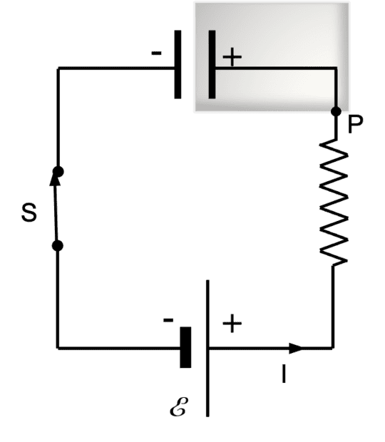

Not in a charging capacitor. That's why the charge continuity equation is needed. Enclose only the positive plate of the charging capacitor with a box of volume ##V## and surface area ##S## (see figure on the right). Starting with the differential form of the continuity equation, integrate over the volume, and use the divergence theorem: $$\begin{align} & \mathbf{\nabla}\cdot \mathbf J+\frac{\partial \rho}{\partial t}=0 \nonumber \\
& \int_V(\mathbf{\nabla}\cdot \mathbf J)dV=-\frac{\partial}{\partial t}\int_V\rho~dV \nonumber \\
& \int_S\mathbf{J}\cdot \mathbf{\hat n}~dA=-\frac{\partial}{\partial t}\int_V\rho~dV =-\frac{dq_{encl.}}{dt} \nonumber \\
\end{align}$$ The only place on the surface of the box where the current density ##\mathbf J## is non-zero is the area of point P where the conducting wire enters the volume. Since ##\mathbf{\hat n}## is the outward normal and ##\mathbf J## is directed into the volume, $$\int_S\mathbf{J}\cdot \mathbf{\hat n}~dA=-\int_SJ~dA=-I$$ Thus, ##I=\dfrac{dq_{encl.}}{dt}.## This says that the charge per unit time that goes into the closed surface accumulates at the same rate inside the surface. Charge goes in but doesn't come out unless the capacitor is discharged.

BTW, that's not a capacitor you cite. It's half of a capacitor, at least for an EE.
To a physicist the figure shows a complete capacitor with a Gaussian (imaginary) closed surface enclosing one of its plates.
Same reason. Batteries don't create charge.
