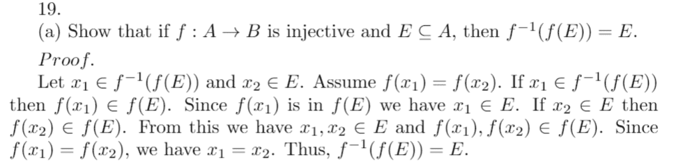

TL;DR Summary
I need help checking my proofs as I self-study math.
I typed this up in Overleaf using MathJax. I'm self-studying so I just want to make sure I'm understanding each concept. For clarification, the notation f^{-1}(x) is referring to the inverse image of the function. I think everything else is pretty straight-forward from how I've written it. Thank you for your help!
You must show that ##x_1 \in f^{-1}(f(E)) \iff x_1 \in E##. No need to introduce ##x_2##. I see why you did that: to get to the definition of injectivity, but it is confusing.
Notice first that one inclusion always holds, without injectivity. Indeed, ##f^{-1}(f(E))## is the set of all elements in ##A## that get mapped to ##f(E)##. Clearly ##E## is contained in this set, so we always have (even without injectivity) ##E \subseteq f^{-1}(f(E))##.
For the converse, the injectivity will be crucial.
If ##x \in f^{-1}(f(E))##, then you know that ##f(x) \in f(E)##. How can you proceed and use the injectivity?
Your proof doesn't make much sense to me. When are two sets equal?
Thank you for the reply! I always forget that to show equality after I have to clearly show that each set is a subset of the other :/
The only next step I can think of is that if f(x) is in f(E), then x is in E, right?

Well if the function is injective then we know that x maps to at most one y = f(x). So I don't think this could be true without inectivity.
You get the idea, but at this point it is important to write down everything in huge detail!

Yes, so we left of at ##f(x)\in f(E)##, so there is an ##e\in E## (do not call this new variable ##x##, this name is already used!) with ##f(x)=f(e)##.
Can you conclude?
Can you conclude?
Well if f(x) = f(e) then x = e.
Yes, so is ##x \in E## true?
Yes!

Congrats, now your proof works!

Well, let's check if you learned from it! Show the following statement (if you want to/have the time):
If ##f## is surjective, then ##f(f^{-1}(E))=E##.

I meant that the OP has now a working proof (not the one he wrote down originally):
If ##x \in f^{-1}(f(E))##, then ##f(x) \in f(E)##, so there is ##e\in E## with ##f(x) = f(e)##. By injectivity, ##x=e\in E##. This shows ##f^{-1}(f(E)) \subseteq E##, the other inclusion is trivial.

An alternative method is to show
1) first that for any set ##E## and any function ##f## we have ##E \subseteq f^{-1}(f(E))##
2) If ##E \subset f^{-1}(f(E))##, then ##f## is not one-to-one.

ok, I've thought about it about. The goal of this proof should be to show that ##y \in f(f^{-1}(E) \iff y \in E##
So to start with ##y \in f(f^{-1}(E)##. ##y = f(x)## for some ##x \in f^{-1}(E)##
Or maybe since it is surjective, it is best to start with ##y \in E## so that we can show that there's at least one x in ##f^{-1}(E)##, such that ##f(x) = y##.
I'd still like to see a proof of the original problem! These are tricky, I think. Again, I recommend the following:
1) Show that we always have ##f(f^{-1}(E)) \subseteq E##.
2) Show that if ##f## is surjective then ##E \subseteq f(f^{-1}(E)) ##.
In other words:
1) ##f^{-1}(E)## are all the points that map into ##E##. If you map them, they all end up in E.
2) If ##f## is surfective, then all the points in ##E## get mapped to by something and that something must be in ##f^{-1}(E)##. Hence all the points in ##E## are in ##f(f^{-1}(E))##.
PS one way to define equality of set is:
$$ A = B \ \text{iff} \ (A \subseteq B \ \text{and} \ B \subseteq A)$$

Thank you for this. It took a while to reply because I had to get caught up on some school work.
Here's what I worked out:
If ##y \in E##, then ##y = f(x)## for some ##x \in f^{-1}(E)##. Clearly, ##f^{-1}(E)## is the set of all points that map into ##E##, so ##f(f^{-1}(E))## will give us all ##y## such that ##y=f(x)## for all ##x \in f^{-1}(E)##. That is all ##y## such that ##y \in E##. Thus, ##f(f^{-1}(E)) \subseteq E##.
If ##y \in f(f^{-1}(E))##, then ##y = f(x)## for some ##x \in f^{-1}(E)##. By surjectivity, ##x \in f^{-1}(E)## maps to some ##y \in E## such that ##y=f(x)##. Thus, ##f(f^{-1}(E)) \subseteq E##.
Why?
I can't follow this at all.
This is not right. Surjectivity means given ##y \in E##, there exists ##x \in A## such that ##f(x) = y##.

Ok, so I was correct in my original thinking. To properly show surjection, I have to start that part of the proof with ##y \in E##.
For the first issue you found, it seems to me that it clearly follows from the definition of inverse images. I'm not properly communicating it I guess :/ I'll go simpler.
If ##y \in f(f^{-1}(E))## then there is some ##x \in f^{-1}(E)## such that ##y = f(x)##. From this ##x \in f^{-1}(E)## implies that ##f(x) \in E## such that ##y = f(x) \in E##.
If ##y \in E##, by surjection there is some ##x \in f^{-1}(E)## such that ##y = f(x)##. So by definition, ##x =f(x) \in f(f^{-1}(E))##.
  • #31
This looks good. However, you ought to structure it a bit better. Especially the second part you need to say up front you assume ##f## is surjective.
  • #32
Let ##y \in E##. Assume that ##f## is surjective. There is some ##x \in f^{-1}(E)## such that ##y = f(x)##. So by definition, ##x =f(x) \in f(f^{-1}(E))##.
At least I finally got something understandable. I didn't have nearly as much trouble proving things about inverse images themselves (i.e. ##f^{-1}(G \cup H) = f^{-1}(G) \cup f^{-1}(H)##). This forced me to more properly understand what is actually being said by "injection" and "surjection".
