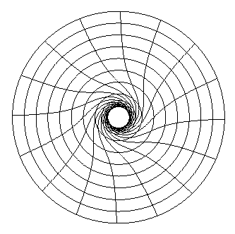

I think the idea that frame dragging means "torsion" comes from visualizations like these:
http://einstein.stanford.edu/MISSION/mission1.html
http://imagine.gsfc.nasa.gov/docs/features/news/20apr04.html
http://cr4.globalspec.com/blogentry/1670/Extreme-Frame-Dragging
Are they inaccurate? Misleading? Is there a better way to visualize it?
No; I think it's fine.
But geometrically this is not torsion.
But how should they be interpreted? What does it mean physically, when the radial lines and the circumferences are not orthogonal? Would radially falling photons be diverted tangentially, and "spiral down" instead of going straight down?
Nothing. At least not directly b/c what is shown are coordinates = reference frames. And they are unphysical i.e. cannot be observed.
A.T. said:
Would radially falling moving photons be diverted tangentially, and "spiral down" instead of going straight down?
Yes! But this does not follow from the reference frames but from the geodesics.
