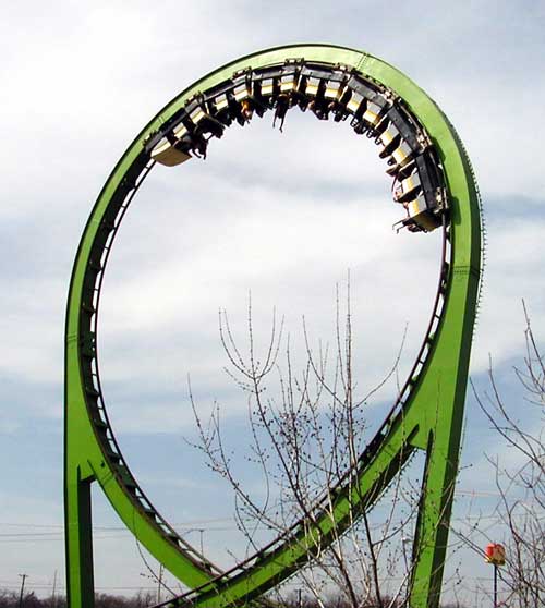

I on the contrary , don't think that a horizontal curve ala Nascar is what they intended to be considered, When we talk about roller coaster we think about vertical loops that defy gravity.
How about this roller coaster?
Clearly we need some energy to go upwards in the loop.
Likes etotheipi and Delta2
