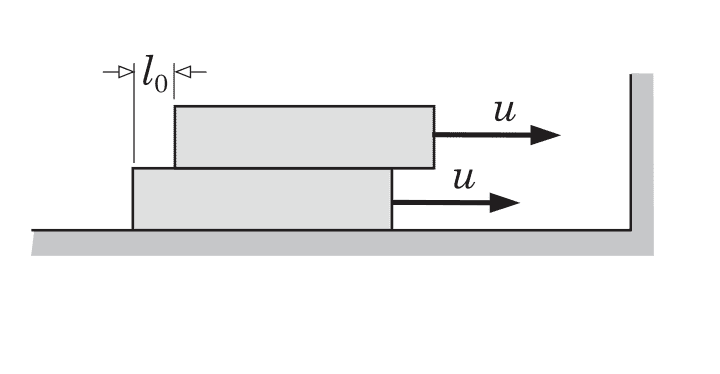

A bar is placed with a slight offset Lo on another identical bar that rests on a horizontal frictionless floor. Coefficient of friction between the bars is μ. Initially, both the bars are moving towards a wall with a velocity u. The wall is parallel to the front face of the bars. (See figure)
If collision of the bars with the wall is perfectly elastic , find final velocities of both the bars long time after collisions with the wall .

When the upper block collides with the wall, the impulse to it will be:
$$ \int (-N+ f)dt = -2mu$$
Where N is the contact force from the wall.
Since N is really huge, the impulse from friction in the first equation above can be ignored, hence the equation become:
$$ \int -Ndt = -2mu$$
Meanwhile, the impulse to the lower one is going to be:
$$ \int -f dt = m(v-u)$$
Where ##v## is the velocity of the lower mass after the collision.
I don't think we can ignore the friction in this one. But if this is true, then I will not be able to find ##v##.
What do you think?

As I showed in the earlier thread, you have to consider what is known, the force or the impulse. If the force is known and bounded then, in the limit as the duration tends to zero, the impulse it delivers tends to zero. But if the impulse is known then, in that limit, the force is unbounded.

The only relevant question seems to be: Is the velocity u small enough and the coefficient of friction between bars enough to prevent the lower bar from also colliding with the wall. If so, the problem is trivial. If the collision still occurs, then one has to actually do algebra, but the only thing that matters is the velocity at which that lower bar hits the wall.
Is ##\mu## the coefficient of static friction or the coefficient of kinetic friction. If the former, what is the coefficient of kinetic friction? If the latter, what is the coefficient of static friction? What would happen if the coefficient of static friction were extremely high?

You have to look at what happens in the limit. In the rocket thread, in the limit, dm and dv are both zero, but what matters is the ratio of dm to dv, and that does not go to zero.
In this thread, you have ##\int f.dt=m(v-u)## and f is bounded, so in the limit ##dt\rightarrow 0##, ##v=u##.

The trick is to think about the two velocities immediately after the top bar has bounced. If the lower bar does not reach the wall then it is indeed trivial. However, being told that ##l_0## is very small implies we should assume it does reach the wall, so there is only the slightly more interesting case to consider.

$$\int -mg \mu d(l) = \frac 1 2 m(v²-u²)$$
Where v is the speed of the lower block just before the 2nd collision.
$$v = \sqrt {u² - 2g\mu l_0}$$
So, there are two answers:
1. ## v = 0##
if ##u² ≤2g\mu l_0##
2. ## v = \sqrt {u² - 2g\mu l_0}##
if ##u² ≥2g\mu l_0##
Do I also need to think of the possibilities if ##l_0## is big/small?
1. ## v = 0##
I'm not disagreeing with your answer, but in your posted analysis of case 2 you have not discussed the continuing interaction between the blocks.
