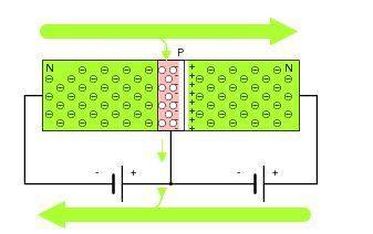

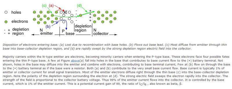

I took this picture from forum aboutcircuits to illustrate current flow in NPN transistor.
Here is what I am confused:
A few at Figure above(a) fall into holes in the base that contributes to base current flow to the (+) battery terminal.
Why these electrons that fall into holes necessary flow into base terminal and contribute to base current flow?
Is it possible that there are some electrons fallen into holes and then go straight into collector?
Or in other words:
When an electron in conduction band from emitter falls into hole in base, it become electron in valence band. I wonder where the electron will go.
- the electron now is in valence band and it moves in valence band to positive lead of battery VBE
- the the electron now is in valence band and it moves in valence band to depletion region in CB junction and here it gets energy from VCB exits valence band and go into depletion region.

Hi, I knew that but here is my problem.
We know that P semiconductor can conduct. In this case consider EB junction. When an electron(free electron in emitter) combines with a hole in base, at the same time, there is another electron (valence electron) from base exit valence band and go into base lead, finally go into positive lead of VBE(battery).
I wonder if the similar occcur:
When an electron(free electron in emitter) combines with a hole in base, at the same time, there is another electron (valence electron) from base exit valence band and go into depletion region in CB junction finally go into collector and positive lead of VCB(battery).

Hello again!
In the image in my original post, they say that when an electron go into base they four possible fates:
a) Lost due to recombination with base holes
My understanding:
After recombination, the electron is in valence band and under the electric field from VBE (battery) it goes to base lead through holes.
My confusion is it possible that the electron after recombination with hole in base, it goes to depletion region in CB juction under electric field from VCB.
( I mean that the electron moves through hole in base and go straight ahead to CB juction under electric field from VCB.)
b) Flows out base lead
My understanding:
Based on the image, I think they mean that the elctron goes to base lead without recombination. In this case, base acts as a resistor.
c) Most diffuse from emitter through thin base into base-collector depletion region
My understanding:
I think they meant that the electron will go straight to CB junction without recombination. And in this case base also acts as a resistor.
My main question is that: Of electrons go to collector is it right that:
- some electrons from emitter to base and collector without recombination. And in this case base acts as a resistor.
-some electrons from emitter then recombination in base, then go though holes and finally go to collector.
I dout about the second, it seems that no books mention the possibility.
Therefore, I am confused. Why the electrons after recombination in base must go to base lead not CB juction?
I may have worded my response poorly earlier, so I'll try to start over, and answer your questions directly.
anhnha said:
Hello again!
My understanding:
When an electron recombines with a hole in in the valance band, that electron becomes bound/attached to a stationary atom in the crystal structure. Neither of them move. Well, that's not totally true. One electron might move to the right if there is a positive atom right next to it. But that can better be thought of as a hole moving to the left.
The electron is more likely to stay attached to its atom in the crystal. Occasionally though, thermal vibrations will create a electron-hole pair, such that the electron enters the conduction band (leaving a hole behind), then quickly leaves the depletion region due to the electric field, while the hole is left behind. That's where the excess holes come from. This doesn't happen as often, but it does happen.
My understanding:
That is a fine way to imagine it.
My understanding:
I believe you are correct. (That was where I may have chosen poor wording in a previous post). Most electrons reach the depletion region without recombining.
I believe your first thought is right. Most of the electrons from the emitter exit to the collector without recombination -- the base acts as a resistor.
Some (not most) recombine with holes.
Some (not most) exit though the base lead (again, with the base acting as a resistor).
Some electrons (not most, and this is not even shown in the diagram) originate from thermal vibrations, leaving a hole behind.
Likes 1 person

Hello,
In a p type semiconductor, there are acceptor levels very close to the top of the valence band. The electron which brakes covalent bond with its atom, goes onto the acceptor level and makes covalent bond with an acceptor atom or other silicon ion where one electron was missing. That electron is immobile, but it leaves a hole in the valence band, which is filled with an other electron, leaving a hole behind, and so on. The holes move. The holes conduct electricity.
I know that but here is my confusion:
In this case (NPN trans) base is also a P-semiconductor, then if there are many electron available in p type, can they move to collector by go though holes?
For example, in this case we don't make base thin instead make it thick and heavy dopping.
Then there will be many electrons recombine into holes. But Why do these electrons (combined) must go to base lead not collector? Both base and collector have positive poles of battery to attract electrons by why they don't go to collector?
I am saying only electrons that recombine in base not free electrons that can go straight to collector.

After the combination, assume that:
1. The first electron go to base's bottom (near base lead)
2. The second electron go to base surface right before CB junction.
Why the first electron easy go out of the hole and go into the positive pole of VBE while the second electron can't exit the hole and go into collector?
I think there might still be some confusion about what happens when an electron combines with a hole.
When an electron combines with a hole:
  • Physically, the electron doesn't go anywhere. It does not "go out of the hole," "exit the hole," or "go to the surface." It stays put in the location that the hole is. In the case of our diagram, the electron and the hole are removed from the picture. In this case, nothing exits to the base lead nor does anything exit to the collector. Both the electron and hole are frozen in place, and both vanish from the picture. (Electrons might move a little bit, between the valance bands of adjacent atoms as holes move through, but this movement is ignorable.)
  • In the context of the diagram, where all shown "electrons" are really extra electrons (in the conduction band), and all "holes" are lack of electrons in an crystal lattice's valance band, the electron and hole annihilate each other and are erased from the picture, so to speak.
But now let's change the question. Let's ignore electron hole recombination for a moment. Let's also ignore electron/hole generation due to thermal action.
Suppose some electrons come from the emitter and enter the base region (the p-type material). (Here, when I say "electron" I mean an electron in the conduction band. I'm ignoring all bound electrons in the valance band).
Some of them, through diffusion, end up down at the base's lead and ultimately end up at the + terminal of the VBE battery.
But due to the geometry of the BJT (with the base surrounding the emitter, and collector surrounding the base [a 3D cross section might be useful here] -- and in particular the base being very thin between the collector and emitter); and due to the existence of the depletion layer, for every electron leaving the base lead, about a hundred (or so) ultimately end up at the collector (also through diffusion, until accelerated at the depletion region). (All electrons I'm speaking of here originally entered from the emitter.)
anhnha said:
I will express my mind more clearly. Hope you can understand what I am saying.
Assuming that there are two electrons injected from emitter to base. Both electrons are combined with holes in base.
The recombined electrons do not move
. They are part of a covalent bond and attached to a pair of atoms. Try to understand that and remember. It was said to you several times.
Electrons do not have personality. Once a conduction electron recombines with a hole it ceases to exist as conduction electron. It just adds extra negative charge to the base.
As the base becomes more negative than in equilibrium, one e charge flows away through the leads into the positive terminals of the batteries, from the existing free electrons in the base (the minority carriers).
During recombination and a free electron leaving the base, the numbers of free electrons and holes in the base change with respect to equilibrium. The balance is restored by an electron breaking a bond and producing a new pair of free electron and free hole.
The electrons traversing the BE junction recombine near it and produce extra charge in that region. If the base is very broad as you said, the depletion region with attracting electric field for the electrons is far away from the BE junction. You have seen that far away from the depleted region, the electric field is zero inside the bulk of the semiconductor. No force drives a free electron towards the CB junction. All phenomena happen near the BE junction, and the extra charge flows away through the base lead.
ehild
Likes 1 person
Hello collinsmark,
I am sorry but it still not clear to me. I will explain my confusion step by step.
Please see the image:
This is my understanding about how holes move in p type semiconductor.
Is this right?
Thanks, half of my confusion is solved:smile:
That is really I want to know, but I wonder why the similar don't happen with collector.
I imagine that when collector is connected a battery positive pole then at the base surface right before CB junction there is an electric field and that would cause the similar thing as base do.
haha, my second confusion is here. I think the reason for no electric field is like this:https://www.physicsforums.com/showthread.php?t=695986
But if so how can free electrons can move to collector?
I heard that free elctrons are swept by a strong electric field here.
There is a strong electric field in the depleted region around the CB junction. If the base is appropriately thin the electrons injected from the base can reach that region before recombining, and sucked away into the emitter.
ehild
