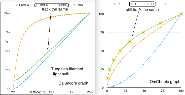

Thanks. I knew that filament would change the resistance. But the difficulty for me calculate the resistance at given voltage. for example, my 42W halogen bulb (I don't have access to 100W incandescent right now) that I tested has resistance of 84 Ohm, which at 238V would draw 674W power but it clearly isnt. But I just didnt know before what formula to exactly use for resistance.
I am also not 100% sure, if temperature of filament matches the color temperature of emitted light (anyone can confirm this?). That table posted here by Baluncore looks great. Only problem is that that to verify it I would need expensive spectrometer as DSLR and phone apps can easily lie +/- 300k, and with ultra warm lights, DSLR can even lie with +/-500k. I asked this because I was wondering if I could somehow easily get reference for different light colors - since incandescent seemed easy and predictable, I hoped I could use it to easily get color within +/- 100k from desired point.
According to one graph I looked at and digitized this morning, they are pretty close.
Color Temp = 1.0495 * (actual temp) - 41.914
Their color temp axis ended at 3500 K, where the discrepancy was 3.8%
[ref: USHIO pdf page 22 figure 48]

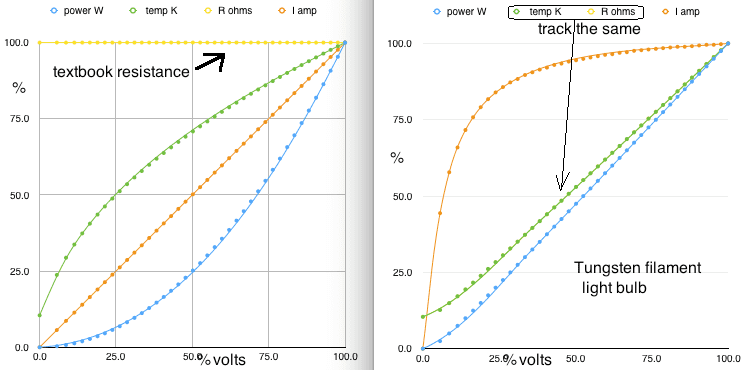

Baluncore said:
Notice how the current is limited at higher powers.
Not really. Gobs of numbers are somewhat confusing to me.
Your comment didn't make sense until I compared it graphically to a fixed resistance.
Fascinating.
ps. The title of a previous PF post now makes more sense: Stupid Light Bulbs
Likes sophiecentaur and Baluncore
Me too. Especially when the units are not familiar. A good old graph delivers the message - and your two are great.
I notice for the fixed resistance, your green Temp K line curves differently to the blue Power line. The tungsten filament model has the opposite characteristic.
How did you compute the temperature of the fixed resistor?
It's computed using the Stefan-Boltzmann equation: j* = σT4
Since the area of the filament doesn't change(much), I simply redefined a new sigma type constant at 100 watts @ 2800 Kelvin.
I labeled it "s".
s = 100/(2800^4) = 1.63E-12
Then I reversed the Stefan-Boltzmann equation to derive the temperature from the given power.
T=(p/s)^(1/4)
Interesting. If I re-plot your data using my method, I get a different graph.
It appears we have a difference of opinion on how to approach this problem.
Perhaps we've gone off topic. Are we still discussing "filament color temperature vs voltage"?

OmCheeto said:
It appears we have a difference of opinion on how to approach this problem.Perhaps we've gone off topic. Are we still discussing "filament color temperature vs voltage"?
We are on topic, but the question has now become “how can you best estimate colour temp based on filament voltage.
I contend that you need to measure both filament current and voltage. From that you can compute resistance to maybe three decimal places. Then using the polynomial relationship between temperature and the resistivity of tungsten, you can accurately calculate the filament temperature.
