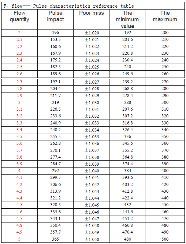

Thanks for the response. I have attached Technical Parameters of the Flow Sensors. Could you please tell me if these can be connected to a PLC? And if so, are there any particular cards you need to get along with your PLC for such connections? I have worked with a few popular PLCs such as Siemens S7 series, Mitsubishi FX series etc.

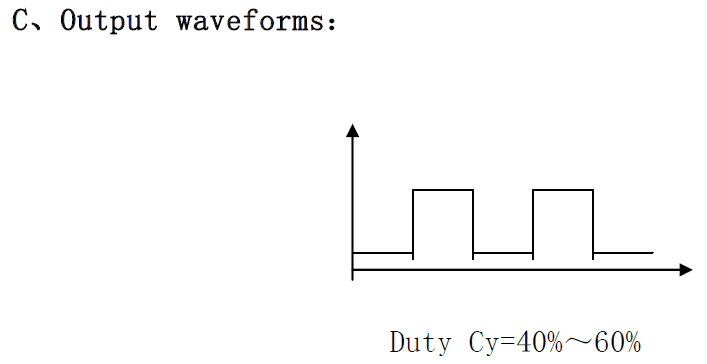

First, output isn't PWM, but is instead a nominal 50% duty cycle pulse with a rather wide tolerance range.

Pulse duty cycle is specified as 50%, +/-10%, but the drawing gives it as a range of 40% to 60%.

A monkey in the wrench is the supplied flow to pulse reference table.
It doesn't show values at either the low or high end of the rated flow range (from 0.3 LPM to 2.0 LPM, and 5 LPM to 6 LPM), which makes me wonder whether the sensor has usable linearity in these ranges.
Stranger still, if pulse frequency is 98 * LPM, it holds true at 2 LPM, but pulse impact (frequency?) is shown going down from 2.1 to 2.7 LPM, and the value of 365 at 5 LPM is far lower than 98*5 (490).
I'm either misunderstanding something, or these specs don't make sense.

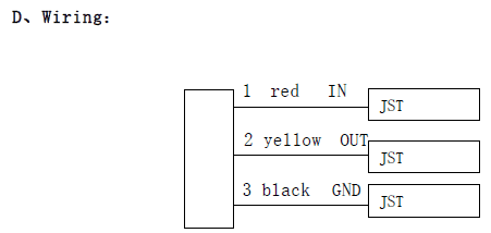

2. Power the flow sensor with an appropriate DC supply, which depends on sensor spec (5 to 18 V), and what the PLC input card you've selected.
3. Connect sensor IN to the DC power supply (+) terminal, sensor GND to the power supply return, and sensor OUT to the desired PLC card input terminal. If the DC supply is external to the PLC, then the supply DC common must be connected to the PLC input card DC common.
