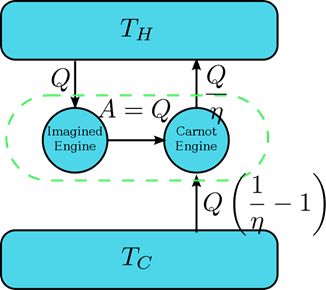

This is the assumption that I ask you to suspend – Assume that a fixed number of microstates all are equally probable and all microstates encourage order.
The scenario I propose (however far-fetched) is one where order can be created by movement between fixed equally probable microstates at static** temperature–
  1. Fixed Microstates - Entropy does not increase nor decrease.
  2. Equally Probable – the equilibrium microstate is the most probable.
  3. Static Temp - as work (order) is extracted that TH constantly resupplies TC so they can be assumed fixed and are so identical over time
What I am chasing is a mathematical proof that prevents such a statistical bias existing creating work (order) from random movement (disorder) and nothing changing over time as Q enters the system to balance W removed.
Can anyone help??
Before we bring them up the to me Smoluchowski trapdoor , Brownian Ratchet all only prove that if all microstates are equally probable then no net work can be extracted as states that extract work are equally probable as states that require work. Not that a bias can assure only positive states are probable.
