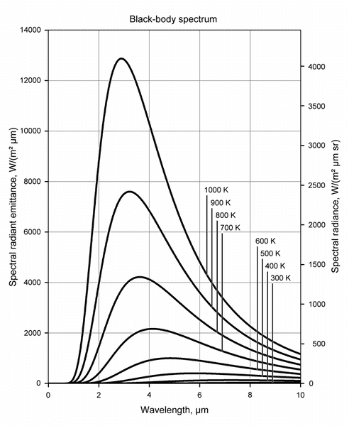

No, it's not possible. If you look at Planck's law graphed for different temperatures, e.g.:
(source: http://www.eumetrain.org/data/3/30/print_5.htm)
You can see that as temperatures rise, the peak emissions move towards the shorter wavelengths, but for any given wavelength the emissions always increase with temperature.
This means that hotter black body radiators (like stars) are always brighter, even though most of their emissions might be outside the visible spectrum.
