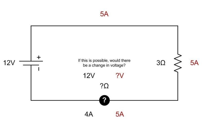

Let's say you have a basic series circuit with a battery power source that has 12 volts. You also have a load of some sort with 3 ohms of resistance. Therefore you'll have 4 amps of current throughout the circuit.
Is it possible to add some item within or along the circuit (and before the load) the could increase the amps on the output side of that item (whatever it is)?
In my question, the current coming from the power source is 4 amps, then after it passes through that item (with some unknown ohms of resistance), it increases to 5 amps (the input amps stays at 4 amps), and then stays 5 amps through the rest of the circuit.
Is this possible?
If it is possible, what would happen to voltage and what would the ohms likely be?
If not can you briefly explain why?

A series circuit is like a bicycle chain in that the current flow move identically throughout the circuit, like the links in a bike chain. So, no, you cannot have one current flowing into a series node and a different current flowing out.
I'm going to disagree with Phinds. If you added a second battery, the voltage and thus the current would increase.
He is correct that the current would need to increase through the entire circuit. It could not be 4A at one point and 5A somewhere else along the same wire -- at least not in a DC circuit.
but you can do this in an AC circuit by using a transformer for example, where by changing the wire thickness and turn ratio you can achieve what you aim for in this circuit.
if you must use a battery which is a DC power source you could also use the age old and very common buck boost converter just google the term and you will see , but since it operates by switching current through an inductor it still isn't quite a dc circuit.
as phinds said in a true DC battery powered circuit you can;t just have different current ratings at different circuit parts.

And even more to the point of the OP's question, there is NOTHING you can do in a resistive circuit that will allow more current in one part of a serial path than in another part of the same path.
Reading the OP again - I would like to point out - IF you are asking about a 2 terminal item ( only one connection "in" and one connection "out") -- then the answer is NO... the the current into that 2 terminal device MUST equal the current out.

Yes. You could add a DC to DC converter that stepped the voltage up to say 24v. Then the current in the 3 ohm would be 8A. However the current drawn from the 12v battery would be at least 16A depending on the efficiency of the converter.
Is this possible?
Not if the device only has two terminals because of KCL.
Imagine a box with four terminals. Two have a 3ohm resistor between them so 4A is still drawn from the 12v battery. The other two terminals have a 15v battery so 5A is output.
