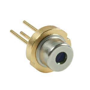

you are not going to make a laser light source at home ... as in modifying a torch or other lamp
but you can buy a laser light source eg a laser diode and build up the electronics circuit around it to make it work
ohhh and you will need some optics as well

electronics, not electrons. If you haven't done any electronics construction, then it may be a project out of your grasp at the moment till you learn a bit more
here is an example of a laser diode ...
the gold coloured bit is about 1cm in diameter
