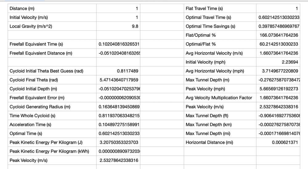

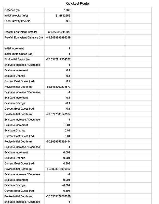

So if the initial velocity is 4m/s in 8m/s^2 gravity, then A is exactly -1m. Suppose I want to build a ramp to go 1 meter (B) horizontally on the quickest path (optimized for time) with 4m/s initial velocity in 8m/s^2 gravity. To find the quickest route we need to know the cycloid generating radius (r) calculated from (B) and (t) but to find this requires first doing a possibly endless task (finding t). Is it possible to find r and therefore build the ramp which has the quickest route?

Like @Mark44 , I don't understand where you are coming from. It is easy to solve this type of problem numerically, and a computer will find the answer to any reasonable degree of accuracy as soon as you hit 'return'. Whether the answer is rational, irrational, or can be expressed analytically is basically irrelevant.

I was just wondering if after any amount of time the computer program would be done solving for t, having found it exactly. I think you are saying the answer is that it’s an endless task though I don’t know for sure.
  • #33
Yes, it's an endless task and the answer will never be known exactly. Just like you will never know the value of pi exactly.

So then does it become possible to show, at a finite degree of accuracy, that in 9.8m/s^2 gravity, with 1m/s initial velocity that the minimum travel time between 2 horizontal points separated horizontally by 1 meter is 0.602... seconds via:
##Time = sqrt(r/g) * dt##
