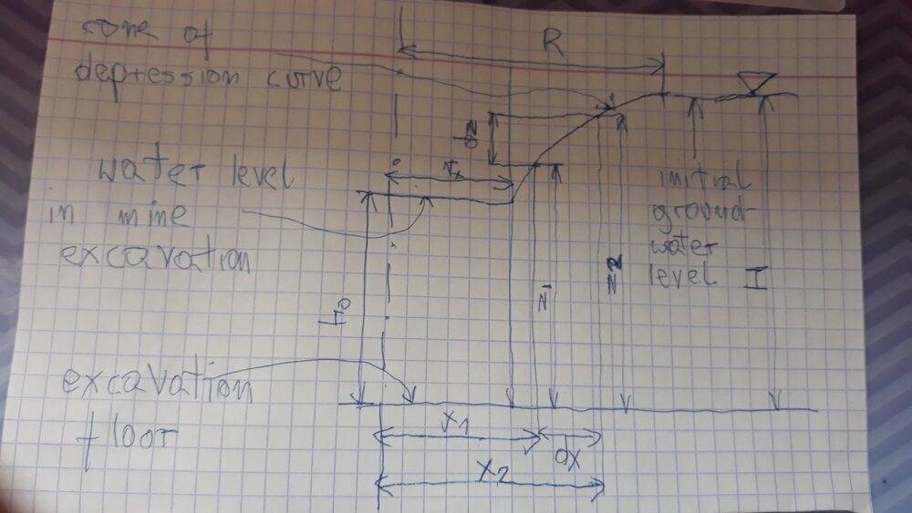

Here is the context for this first equation in starter thread:
We have open pit mine (to excavate sand). Excavation area is circular with radius of [tex]r_{0}[/tex]Groundwater flows through the sand to excavation area from the height of [tex]H[/tex] Maximum radius of depression cone is [tex]R[/tex]Water level in excavation area is [tex]h_{0}[/tex]
Assumption:
Q= const (Q- volumetric flow rate it equals area times velocity in x direction[tex]Q= Av_{x} [/tex]
so:
[tex]Q_{1}=Q_{2}[/tex]
[tex]A_{1}v_1=A_{2}v_{2}[/tex]
[tex] 2 \pi x_{1}z_{1} \frac{dx_{1}}{dt}=2 \pi x_{2}z_{2} \frac{dx_{2}}{dt} [/tex]
[tex]x_{1}z_{1} \frac{dx_{1}}{dt}= (x_{1}+dx)(z_{1}+dz) \frac{d(x_{1}+dx)}{dt}[/tex]
I accept that point [tex](x_{1};z_{1})[/tex] is any point that belongs to cone of depression curve. it means that:
[tex]x_{1}=x[/tex]
[tex]z_{1}=z[/tex]
Then I canceled [tex]dt[/tex] from the equation, however I would prefer to get z(t) and x(t) function but it seemed easier to get the z(x) functionwhat's why I did this cancellation.
Next I separated variables z,x to prepare the equation for integration and that's how I got this first equation in starter thread:
[tex]\frac{z}{z+dz}= \frac{(x+dx)d(x+dx)}{xdx}[/tex]
Likes Delta2

Here's what I would do: From the drawing, find (by approximation) a formula for the part of the curve identified as "depression curve." This should be relatively easy to do - a cubic spline would do nicely. After a formula is found, you'll have a functional relationship between x and z; i.e. ##z = f(x) = a_3x^3 + a_2x^2 + a_1x + a_0##.
Then you would be able to write an equation in terms of ##x, z, dx,## and ##dz## to come up with a differential equation that is actually solvable.

@Mark44 I don't understand what you mean:
I can suppose that you tell me to find the exact formula which must be an approximation of the real depression curve. You suppose it could be cubic spline. But how can I find these ##a_{0},a_{1},a_{2},a_{3}## coefficients If I don't know the real depression curve? That curve is what I'm looking for. I can tell you also that this curve is not tangent to any horizontal or vertical line at any point.
Then I thought that you just say to substitute the z, dz, dx with this 3rd degree polynomial (whose coeffiecients are unknown) to my equation which I struggle to solve. So I would have then 1 equation with 6 unknown variables: ##x,x_{2},a_{0},a_{1},a_{2},a_{3}## (such that ##x_{2}-x=dx## and ##z_{2}=f(x_{2})##). It still doesn't gives me the values for these coefficients.
I also doubt that one 3rd degree polynomial would be good approximation of real depression curve, because the picture is not about the true scale - the real curve is highly stretched in x- direction in comparison to that picture ( "R" value is like 200- 1000 meters when "H" is only about 6 meters).
Depression cone calculations are well known to hydrologists. I searched groundwater level depression cone calculation, and found this MS thesis: http://www.math.clemson.edu/~warner/ground.pdf. It has a number of references that appear to directly answer your question.
Likes rhcp89 and hutchphd
rhcp89 said:
You suppose it could be cubic spline. But how can I find these a0,a1,a2,a3 coefficients If I don't know the real depression curve? That curve is what I'm looking for.
You showed a graph of the depression cone on graph paper -- you can estimate x and z coordinates directly from the graph paper, assuming that the graph is drawn to scale. @jrmichler also gave a link to a paper that talks about groundwater depression cones.
That drawing was just a draft to give you the idea of the problem and as I said it's completely not in scale.
Then you could either make some measurements to get a more accurate drawing (I assume this would be possible), or you could take a look at the link that @jrmichler provided.
