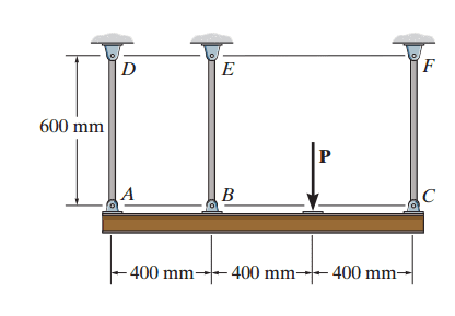

Calcular the force P when a bar starts yield, when 2 bars start yield, and when the 3 bars start yield
Diameter = 25 mm (for every bar), Yield Stress of Steel = 250 MPa.
[/B]
[F][/AD] + [F][/BE] + [F][/CF] = P
2[Δ[/AD] - 3[Δ][/BE] + [Δ][/AC]= 0
I calculate first what happened when the 3 bars were in elastic zone, with the Hooke law I obtain:
[F][/AD]= 0.14P
[F][/BE]= 0.29 P
[F][/CF] = 0.57P
So the firs bar in reach yield stress is CF.
0.57P = [σ][/y] * A => P=215, 295.54 NWhen the 2 bars (BE and CF) are with the yield stress, [F][/BE]=[F][/CF]
From equations of equilibrium, sumatory of moments in C:
0.4P = 1.2 [F][/AD] + 0.8 [F][/BE]
and I know from the eq (1) [F][/AB] + [F][/BE] + [F][/CF] = P, so 2[F][/BE] + [F][/AD]= P. Solving this 2 eq. I obtain P=243, 605.30 N and [F][/AD]= -1831.62 N ...So I don't know if this answer is correct, because it says that the bar AD now is in compresion, when before it was in tension

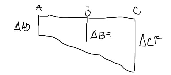

Can you explain how you got this equation?
From semejant triangles, ( delta AD - delta BE) / 0.4 = (delta AD- delta CF) /1.2. Is the C.G.D compatibility geometry of deformation
What is Δ? Maybe a picture would help.
OK, I see now. The ΔAC was a typo then.
Can you show how you used Hooke's Law to get the forces?
