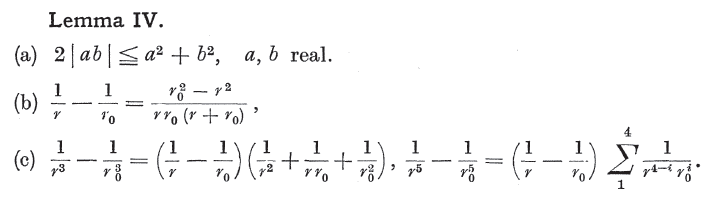

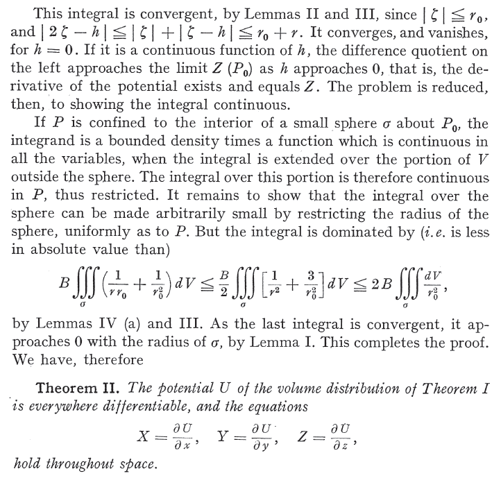

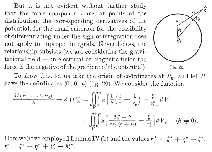

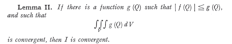

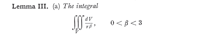

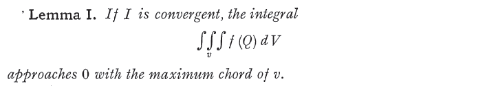

The following passage from the book "Foundations of Potential Theory page 151" says the technique is not valid. But it says the equation ##\mathbf{E}=-\nabla \psi## still holds at points inside source regions ##V'##. It also gives a "little" proof of the argument.
(continued below)
