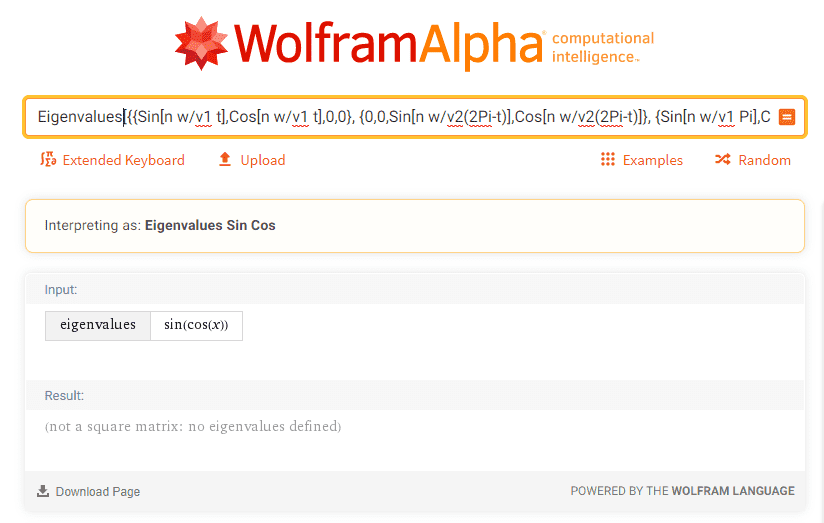

I've been trying to compute the eigenvalues but there's something going wrong. I've copied/pasted the code you provided and I got a wrong output.
But you indeed got a good output.
What am I missing?
OK I confused WolframAlpha with WolframMathematica.
Now it is clear.
