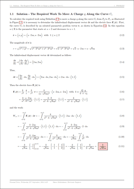

I would like to confirm whether my solution is correct.

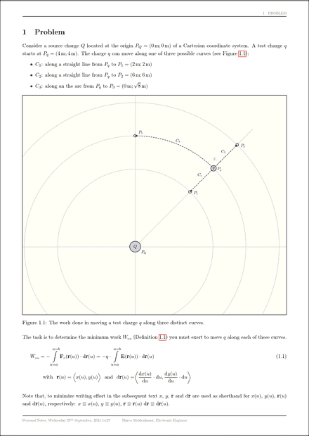

I created a problem for myself, which I have documented in LaTeX. I hope it's acceptable that I included snapshots of my pages.
I would like to calculate the Work W along curve C1.
I have solved the problem as shown below. Is my solution correct (see Equation 1.11)?

Your final result seems to have the wrong units.
But what's the point of doing this?
Hello Nasu, The goal is to improve my understanding by practicing vector line integral problems in physics, specifically those related to electrostatics. Why is the Unit of W not correct? q in [As], Q in [As], e0 in [As]/[Vm] so k in [As]*[Vm] and finally W in [As]*[Vm]/[m]=[VAs]=[Ws]=[Nm]=[J]. So the unit is correct, right?
Thanks and best regards.
What is the meaning of "m" in The denominator of your final result? It looks like "k" divided by some quantity in meters. Which does not have dimensions of work.
