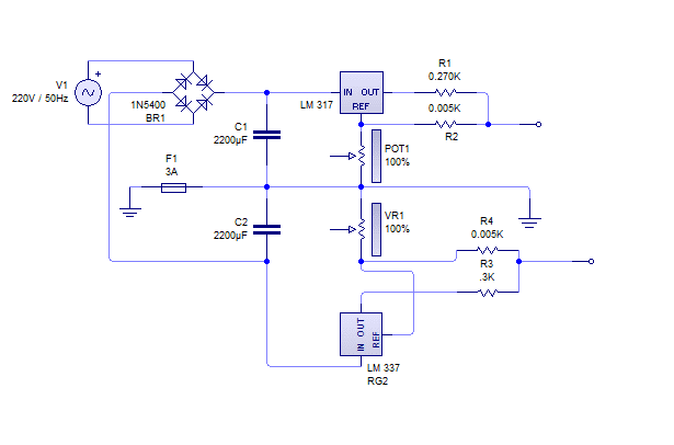

So the circuit drawing is in this link http://i.imgur.com/jVYm5La.jpg . Basically, we have to create a power supply circuit and using Livewire and PCB wizard program in conjunction, I created this circuit
None?
[/B]

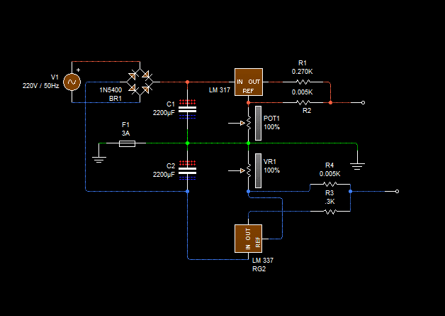

I can't seem to know exactly if this is correct or wrong when I recreate this using the program. I tried using the Play function in Livewire and the green current seems to have no Voltage. I'm also wondering if I misplaced some polarity of the Voltage regulators there.
Sorry, I'm a bit new to using these programs
A couple of observations: Your pots are not correctly connected. F1 is not serving any purpose.
Looks like the fuse is in the wrong place.
I think you will need a pair of bridge rectifiers—one for each side of the power supply.
Are you going to use a transformer between the 220V and your rectifier?

I completely forgot though, the transformer is a step-down one so the input would only be 25V
Edit: How about the Voltage regulators? Is there something wrong with it?

By this I mean one bridge rectifier for the positive regulator, and a second bridge rectifier for the negative regulator.
I think you should search on google for a few schematics of a dual regulated power supply, and model your circuit on those.
The output terminals (both of them) are connected to the wrong spot.
I second the suggestion by @NascentOxygen about a Google search for schematics.
Although your basic circuit architecture can work in some conditions, please consider using a transformer with a Center Tapped secondary or two individual secondaries.

Yes, very. You're mixing up the output vs. ref pins and then the circuit needs to be still further reconfigured (basically R1 ⇔ R2 and R3 ⇔R4 value-wise). Look more carefully at how the lm317 is supposed to be hooked up. Same with the lm337. As in here http://www.ti.com/lit/ds/symlink/lm317.pdf
