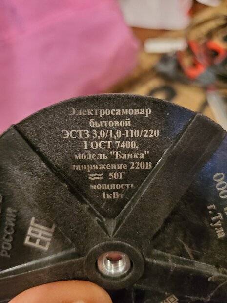

Here is the base plate and below is a Google translate from Russian. Not sure I necessarily believe the baseplate as the vendor is telling me he checked with the manufacturer and they told him this is a 110V element. But then why does it take 45 min to heat the water? Also....the google translation have to take with a grain of salt as well. Not sure it is 100% accurate.
Household electric samovar ESTZ 3.0/1.0-110/220 GOST 7400,
Model "Bank" voltage 220V 50g Power 1kB
