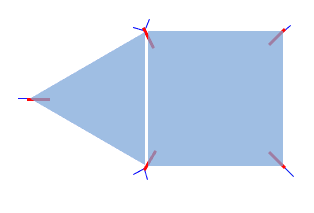

Hello all I bought some square steel tubing today in hopes of putting up sail shades in my back yard, I am concerned now that I did not get big enough tubing.
I have a triangular sail shade 20’ x 20’ x 20’ and a rectangular shade 20’ x 16’.
I bought 3”x3” 11 gauge (.120) steel tubing. 2 pieces at 14’ each and 1 piece at 10’.
I plan on concreting the steel tubing in the ground, 10 ft piece about 3.5’ in ground and then 14 ft pieces 4’ in concrete so they all form a triangle.
I will put up triangle shade, then with the rectangle I will attach between house brick and the tall poles.
Did I get too small of steel for this application? I already bought the tubing and hauled it home.

I'm having trouble picturing how this all goes together. Can you attach a sketch?

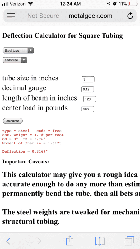

If you know the specifications for both, the first point of failure should be no surprise. With that much lever arm, you can permanently bend that 3x3x1/8 post with a 3/8" eye bolt connection at the top without breaking the eye bolt.
If it was mine, I'd expect it to be at least 6" sch 40 structural pipe, which will tolerate 1000 lbf at the top, and work out the foundations when I had some expected load information (lateral and uplift) from the manufacturer. What you have is effectively a staked tent, and you don't know how big the stakes need to be. You don't want the tent to blow away with the stakes.
If you absolutely, positively, can't change materials for your posts, you still need to know the load information. You may be able to use them with guy wires or anchors if the load is too great unsupported, in the same way power poles are braced.

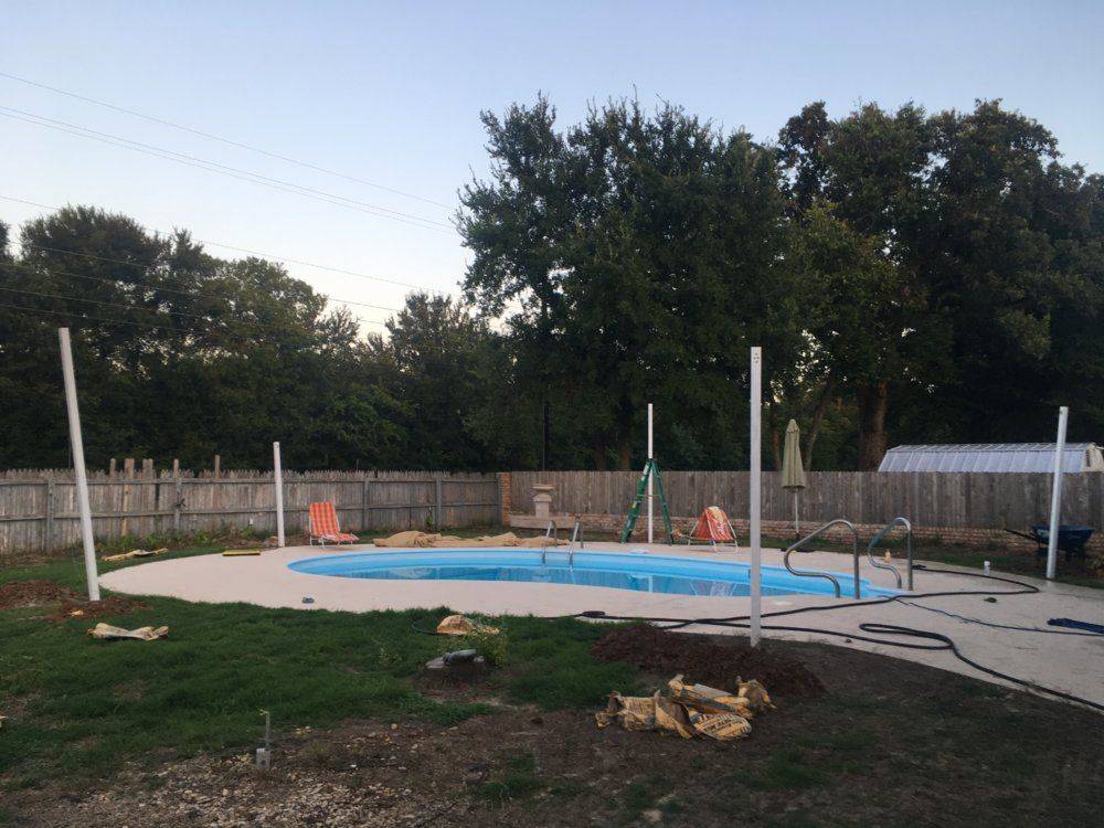

Thanks for all of your suggestions. No turning back now. Part of me wishes I went with a 4 inch maybe a little heavier but let’s see how it reacts in a real world application. I may just need to monitor weather and pull sails down when it gets windy or try to find a fabric that will put less stress on poles.

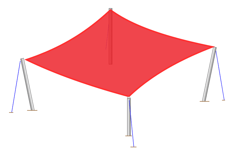

You might consider two guy wires from the poles that join the square and triangle pieces. You want the guy wires to - as directly as possible - oppose the pull from each sail, otherwise they're useless.
Also, you said foot and a half from the top - the farther down from the top you attach them, the more deflection you will be allowing - and the greater transverse forces. As Spinnor points out, you want the pole to experience only compressive forces - that's what they're good at - not torsional forces.

Ideally you want guy-wires to be 90-degrees to posts. That would make for some long runs in this case. If the posts were 45-degrees outwards, then wires would be 45-degrees in other direction.
