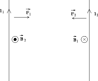

I'm really conflicted with this one, I found many sources that state that Newtons 3rd law does not hold in electrodynamics, reasonable sources with mathematical proof(example). And as a student who just finished Physics I and taking Physics II course, this is really confusing... but when I think about it, like a simple set-up of a solenoid and a wire placed in front of the solenoid, and allow current to flow in both conductors to create their magnetic fields, the magnitude of action/reaction pair are not equal(correct me if I'm wrong please!). The magnetic field of the solenoid is greater than the magnetic field created by the single wire, and the only forces that would represent the action/reaction pairs is the Lorentz force acting on both. And when I write down this example and work it out, they are not equal. Am I getting this right? Or is there something I'm missing?

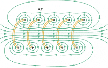

Each loop/turn of the solenoid experiences an equal and opposite force that it puts on the single external loop of wire. Thereby the solenoid is pulled towards the single loop with the same force that the single loop experiences and thereby Newton's 3rd law is obeyed.
Let's use the example I studied, assume 4 loops creating a solenoid, each having current ##I## flowing within, they add up their magnetic fields to create one net field ##B## now, those loops experience a Lorentz force on themselves similar to this diagram:
But when their magnetic fields add up like so:
And the net magnetic field ##B## is perpendicular to the wire it's magnetic field ##B## > ##B_w##(aside from their currents(##I_s , I_w##), might not be equal). Their forces are not the same, hence the conservation of momentum would be accurate for this system.

I think one part of Newton's 3rd Law is the idea of equal and opposite forces. In an E&M class in college, the instructor presented a detailed and accurate vector calculus proof that when two (stationary) loops of wire are each carrying a current, the force on one is equal and opposite the force on the other. From the discussions that followed, along with the idea that the total momentum is still conserved when the fields are included, we really have not discredited Newton here. The electromagnetic field is a little more complex than anything Newton considered, but his inputs are still good science.
This is a situation with constant fields, so you can show momentum conservation while ignoring the fields. But even there, the forces are not exerted by the wires themselves, but by the fields, which depend on what the current in the other wire was a moment ago. "Coincidentally", the current is still the same, so it becomes much easier to make the calculations as if the current is exerting the force (Biot- Savart).

Thank you. A very good example. One minor correction, if I got my cross products correct, is that the magnetic force on particle B is in the downward (negative Y) direction. The magnetic field lines from particle A go clockwise when looking downward, and Qv x B for particle B points downward... On subsequent review, you have particle B moving radially inward, thereby, yes, the force is upward, and you are completely correct. Also, the above example seems to suggest that the magnetic forces on two current loops may not necessarily be equal and opposite. The proof that I saw in my E&M class, (it was quite some time ago), may in fact have been in regards to mutual inductances and not about forces or torques.
A google of the subject gives problem 5.49 of Griffith's E&M textbook, that the magnetic forces on two current loops are indeed shown to be equal and opposite. The above example of the two moving point charges that don't have equal and opposite forces is quite interesting, and also appears to be completely correct. It seems to ensure a correct answer, the calculations need to be worked out in detail and it is difficult to assess whether a simple application of Newton's 3rd Law is going to yield the correct result.
