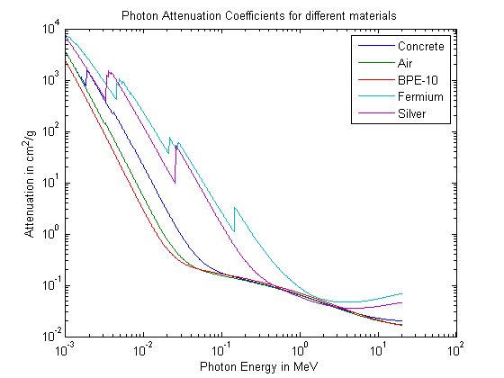

I don't understand. Where did you get the 1ev value? Wikipedia states that 66 kev is necessary for dt fusion, and the gamma rays produced by annihilation have at least 511 kev of energy. I don't fully understand why these rays can't be used to heat up nuclei. A second, separate question. What if you shot the positrons at a non-ionized target instead? Wouldn't that rip the electrons out and also release gamma rays at the nuclei creating energized ions that are likely to fuse?Also I never proposed using X-rays, so I was confused by your last sentence...
Also I was under the impression that while gamma rays are difficult to absorb for whole atoms, they are more easily absorbed by nuclei.
The actual probability of two ions fusing when they collide is very small. Most of the time when the ions collide they bounce off of each, exchange a little energy, and do not fuse. This simple fact necessities the need for confinement. If you want to produce energy, it's not enough to heat a plasma up to several tens of KeV. You have to confine the plasma for many collision times. Heating the plasma is easy. Confining the plasma is hard.

Electrons are lighter, they pick up more energy if electromagnetic radiation hits them.
Vardaan Bhat said:
Why doesn't the tennis ball analogy apply to X-rays too?
It does, but the heating mechanism is via the electrons, not via the nuclei, as mentioned.
