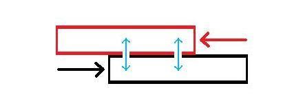

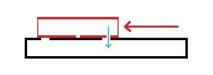

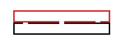

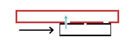

Here is a simple thought experiment. Consider two boxes with equal volume and air pressure when at rest with respect to each other and at rest wrt reference frame S. There are also some ports to allow the pressure to equalise as in the diagram below.
Now both boxes are accelerated to equal speeds wrt S but in opposite directions. Initially the equalisation ports close, but another set of ports align to allow air to move in either direction. Since in this reference frame, both boxes have length contracted to the same extent, the pressures should still be equal and there is no reason to expect any net flow of air from one box to the other.
Seen from the rest frame of the black box, the red box is length contracted and if we assume a resulting increase in pressure in the red box there should be a net flow of air from red to black. Black should measure an increase in pressure and red should measure a loss of pressure. Black gains a detectable amount of atoms.
Seen from the rest frame of the red box, the black box is length contracted and there should be a net flow of air from black to red. Red should measure an increase in pressure and black should measure a loss of pressure. Red gains a detectable amount of atoms. This a physical contradiction to what is measured in red's rest frame.
Therefore it seems reasonable to conclude that pressure (as understood in the context of the gas laws) is a Lorentzian invariant, or in relativity gas does not flow from high pressure regions to low pressure regions.
P.S. This analysis only demonstrates that transverse pressure is invariant and agrees with the result ##p'_y = p'_z = p## given by WannabeNewton in post #2, but does not address the parallel case ##p'_x##. That case was analysed at the molecular level by pervect and myself in the context of gas pressure in the old thread linked above in my earlier post.
