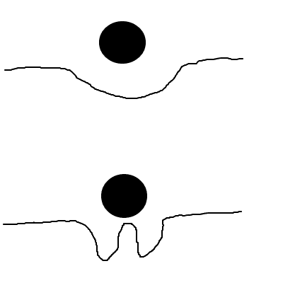

There is also the second question: Assuming the the curvature of space is continuous function, if there are any regions within the interior of an object that have zero curvature, do these occur abruptly, or does space become less curved (begins to flatten) towards these regions with no curvature inside of an an object?
Which of the above two pictures best represent gravity for a mostly homogeneous object.

Curvature can be discontinuous in GR. The metric needs to be continuous but its derivatives needn't be. For example, a solid sphere of constant density with radius ##r_g## and Schwarzschild radius ##r_S## has Kretschmann scalar (##K=R^{\mu\nu\rho\sigma}R_{\mu\nu\rho\sigma}##, a one-number summary of the curvature tensor) ##K=15r_S^2/r_g^6## at the surface using the interior metric and ##K=12r_S^2/r_g^6## using the exterior metric.

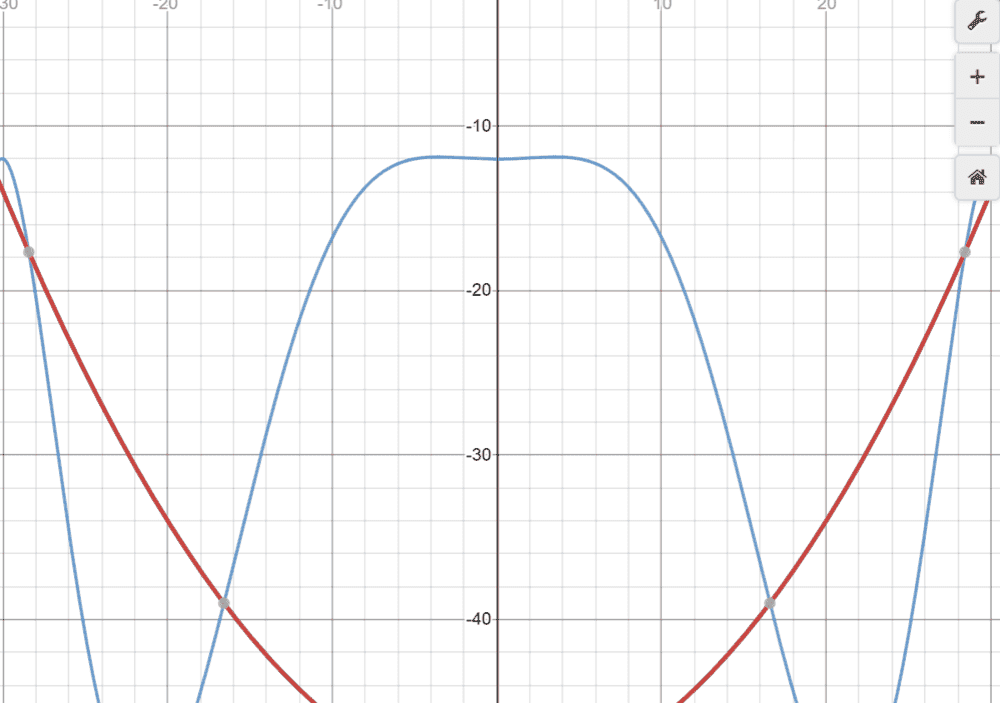

Overall, I just wanted to know if the 2D profile of a gravity well of common celestial object (a massive homogeneous spherical/ellipsoidal object) is shaped like a U or W.
Red Line = U; Blue Line = W
”Gravity well” is a property of the potential, so can be described without involving curvature and tides.
You can calculate the potential using just classical gravity ignoring relativistic effects; for bodies like the sun and the Earth that’s enough to determine whether it’s a U or a W.
Likes Ibix

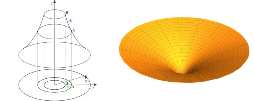

Are all outside of the star? Then you can use the external Schwarzshild metric:
From: https://www.researchgate.net/figure/Cone-like-embedding-diagram-visualizing-the-equatorial-plane-curvature-of-the_fig2_335210694
The distance ds on the upper diagram is the real physical radial distance (proper distance). The distance dr on the lower is calculated from the circumference or surface area using Euclidean formulas (assuming flat space).

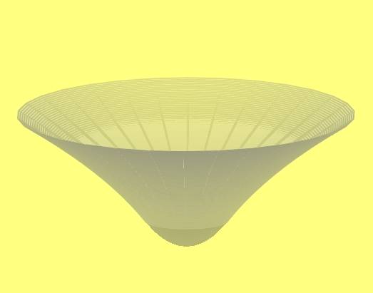

But if you go inside it looks like this the round tip at the bottom here:
From: https://en.wikipedia.org/wiki/Interior_Schwarzschild_metricSo the spatial "distortion" expressed as the ratio ds/dt is greatest at the surface, and goes towards zero at the center and towards infinity. But note that:
- This spatial "distortion" is not related to gravitational pull itself. In fact it doesn't affect objects initially at rest at all.
- The spatial curvature is not zero at the center (its a spherical geometry), and neither is space-time curvature (not shown here).
