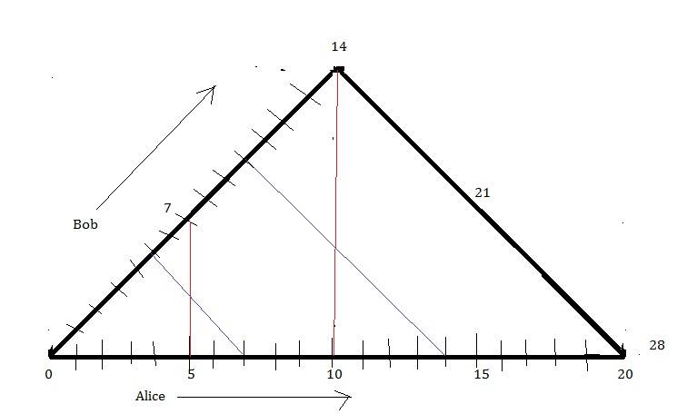

stevendaryl said:
In Bob's frame, e2e2e_2 and e5e5e_5 are simultaneous. So Bob concludes that he is 5 years older than Alice.
In Alice's frame, e3e3e_3 and e4e4e_4 are simultaneous. So Alice concludes that she is 5 years older than Bob.
This seems to be weird to me. Do you mean that when Bob and Alice meet together at the same place and the same time, Bob will see 5 years older than Alice and Alice will see 5 years older than Bob? It is so much confusing me.
Let me label two sentences as follows.
S1: Bob will see himself 5 years older than Alice.
S2: Alice will see herself 5 years older than Bob.
Your statement is forcing me to believe that both S1, S2 are true at the same time and same space when they meet. So from S1, I, from the view point of 3rd person, conclude that Bob(S1)=30 Alice(S1)=25 and with this condition, S2 must be true so that Alice(S2) = Bob(S1) + 5 = 30 + 5= 35 which is not equal to Alice(S1)=25. If you dislike the engagement of 3rd person, I can make an additional rule such that at ever year, they will add a star shaped sticker on their face so if he is 30, then he will get 30 start stickers on his face. In this way, they can compare their actual age with the other without the engagement of 3rd person. Using the scheme that put additional sticker on the face at every year, I wonder what the number of stickers Bob and Alice will see on their faces when they meet at the same place and the same time. My argument is that only one among S1 and S2 must be true and both cannot be true when they meet together. I think it is contradiction if Alice(S1), which is determined by considering S1 only, is not the same with Alice(S2), which is derived from considering S1 and S2 both.
If S1 and S2 both cannot be true at the same place/time, then it is so confusing what is the true meaning of "both view are valid under SR".So what will you say about the number of stickers on their faces when they are at the same place?

Others here are more knowledgeable than me on the subject, but I think they have missed the main source of the misunderstanding.
Answers such as stevendaryl's are based on the assumption that Alice and Bob will never be reunited, and will only know about the other through speed-of-light communications. This is the only case where both can always be in inertial reference frames. Everything is symmetric: both see the other as aging slower.
You have in mind a scenario where they get reunited. This falls back to the twin paradox, which is resolved by the fact that symmetry is broken: one of the twins must turn around to be reunited with the other. Acceleration is necessary for this to happen, hence you can't say that they are both associated with an inertial reference for the duration of the trip.
To expand slightly on DrClaude's comment, the symmetry you, OP, are talking about holds between inertial frames of reference. But for two people to start at one point and meet up again, at least one of them must change frames; otherwise they just drift further apart. If they do choose to meet up then the details of how and when they accelerate will lead to a unique answer for who will be the older when they meet. One may be oldrr than the other, or they may be the same age - and while both will have different reasons for predicting which it will be, they will agree.
If they never meet up again they can never compare their clocks again without making assumptions. Since the natural set of assumptions for two people in relative motion are different they have different impressions of whose clock is ticking faster.
If Alice and Bob continue away from each other at constant velocity, then they can never meet. In order for them to meet, one or the other (or both) must change direction or speed of their motion. To figure out which one is older when they get back together, you must look at how they move to get back together.
The picture below shows an analogy to the "paradox" of mutual time dilation that occurs in good old 2-dimensional Euclidean geometry. Alice and Bob are traveling in their cars, and they come to a fork in the road, represented by the lower left vertex of the triangle. Bob decides to take the road that goes to the northeast, while Alice decides to travel straight east. Assume that their two roads make a 45 degree angle. When they get back together, who will have traveled the farthest?
Here's Alice's reasoning:
There are markers on each road that tells how far we've traveled (in miles). When I get to road marker #5 on my road, I look straight to my left, and I see that it corresponds to marker #7 of Bob's road. Similarly, when I get to road marker #10 on my road, I look straight to my left, and see road marker #14 of Bob's road. Bob's markers are increasing faster than mine, so when we get back together, Bob will have traveled farther. (In the picture, the red lines indicate Alice's view of which of her markers correspond to which markers of Bob.)​
Here's Bob's reasoning:
When I get to marker #5, I look straight to my right, and see that it corresponds to marker #7 of Alice's road. Similarly, when I get to marker #10, it corresponds to Alice's marker #14. So Alice's markers are increasing faster than mine. So when we get back together, Alice will have traveled farther (In the picture, the blue--or maybe they're purple--lines show Bob's view of which of his markers correspond to which of Alice's)​
So who is right? Well, Alice is. When they get back together, at the lower right vertex of the triangle, Bob will have traveled farther. Does that mean that there is an absolute answer to the question of which road markers are increasing faster? No. The difference between Alice and Bob is that Bob makes a right-angle turn half-way along his trip. When he turns, he completely changes his view of which of Alice's markers correspond to which of Bob's. Immediately before Bob's turn, at the top of the triangle, if he looks to his right, he will see Alice's marker #20. Immediately after he turns, when he looks to the right, he will see Alice's marker #0. So when he makes the turn, the correspondence between his marker and the corresponding marker for Alice changes. Because of this, Bob's accounting of how long each of their trips is will be wrong.
A similar thing happens in the twin paradox. For the two twins to get back together, Bob must change his velocity (assume it's Bob). During this change, his notion of which of his birthdays correspond to which of Alice's birthdays must change abruptly. Because of this change, Bob's accounting of their relative ages will be wrong when they get back together.
