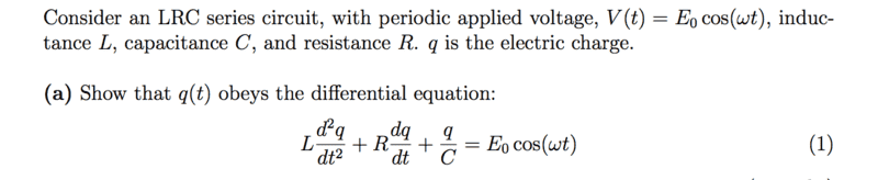

How does one show that q(t) is indeed a solution?
My current idea is that i should come up with any form of solution, like q = Acos(ωt), and slot it in the RHS.
Reason being that if q is indeed a solution, the result of the substitution should look something like the RHS.
Am I missing something? Thanks in advance.

I would read the question differently than you did.
I think that this is a modeling question, because no expression for ##q## is given yet. What I would do, is show from basic circuit principles that the dynamics of the charge as a function of time is modeled by the given differential equation.
Only in the next step(s), you will then probably be asked to (or led to) find the solution of that DE.

No, as Krylov has said, you have mis-read the question. The question said "Show that ##q(t)## obeys ... " so it is not asking for a solution of a differential equation. It is asking you to prove that the given differential equation is a correct formulation.
The point is: first you get the correct DE; then you worry about solving it.

So what you mean is that I should first derive the equation? (Apologies if I was slow to understand this)
But say I've already derived the equation, do I still need to check whether or not it's "correct" by substituting q = qp + qc?
