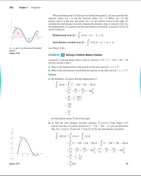

Here is the picture of the relevant problem from my book, perhaps I am misusing the term arc-length to describe the length of the curve. However, I am still stumped regardless.
In the example, the form of the velocity-distance relationship used pertains to one particular form of motion: rectilinear motion, where the particle is traveling in a straight line. For particles traveling along more complex paths, you would need to solve the system of differential equations which describe the motion of the particle.
What you're asked to do is not to find the length of the curve ##v(t)##. The formula
[tex]\int_a^b \sqrt{1+ (v^\prime(t))^2}dt[/tex]
would be the arclength of ##v(t)##. But that has no physical significance and is not what you need to find.
You are given at any point ##t##, the velocity of a particle ##v(t)##. This velocity changes over time. You are asked to find the total distance that the particle traveled. This is not the same as the arc-length of ##v(t)##. It does happen to coincide with the area below the ##v## graph.
Likes 1 person
Thank you for the help, I was under the impression that the given function was position-time, not realizing it was in fact velocity-time. This confused me because I knew summing the distances between the points of a position-time graph would give total distance traveled, and then I saw what I thought was the book finding that same result using integration. This then led me to believe that the length of the curve of the graph was equivalent to the area under the curve (which doesn't make sense for a number of reasons).
