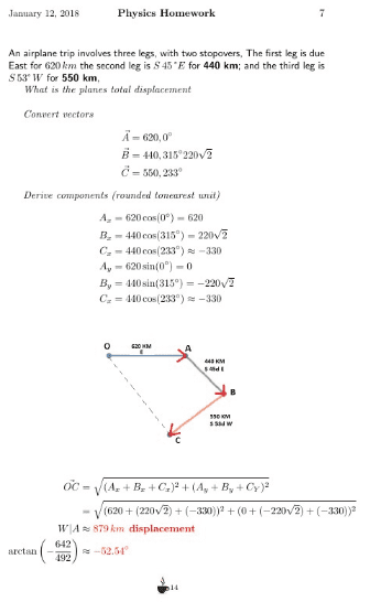

ok this is due 011418
I think its correct but suggestions
didn't know the best format for this
Mathematics news on Phys.org
Two things wrong.
First, the angle for the final leg. If the angle for the first leg is $0^\circ$, that means you are starting angle measurements from the eastward direction. So the angle for the third leg is $270^\circ - 53^\circ = 217^\circ$.
Second, for the $y$-component of the final leg you have repeated $C_x$ instead of calculating $C_y$.
ok i see the c_x error
but isn't due east mean heading east?
$\sqrt{(620+(220\sqrt{2})+(-264))^2+(0+(-220\sqrt{2})+(-264))^2}\approx881 \, km$
hopefully
