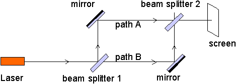

Here's another experiment that illustrates what needs to be considered when determining where a particle lands.
A Mach-Zehnder interferometer is a fairly simple device that splits a laser beam and recombines it to form an interference pattern.
It's described here: https://web.phys.ksu.edu/vqmorig/tutorials/online/wave_part/
And shown here:
Once it's set up and running, it looks like this:

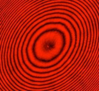

Actually, with a red laser, the projection looks like this:
The first thing to consider is this, not all of the photons coming out of the laser land in the same place - even though the target (the screen) isn't changing. So clearly something more than the target is involved.
Notice in particular that there are dark areas in the pattern where photons never go. Each photon interferes with itself so that when it lands on the screen, it can be anywhere except the darkest places.
In that first diagram, you will see that there is a path A and a path B. If I block path A, the result will be a solid red blur being projected onto the screen.
Now consider the photons that are landing where those dark bands used to be. The reason they are getting there is because path A is blocked. But they obviously didn't take path A, because if they did, they would have hit the block and would never have reached the screen. Instead they took path B. They reached their location on the screen because they could have hit the block but didn't. So even things that didn't happen can affect where the particle is detected.
