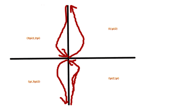

Consider the curve ##r=\tan t## for ##t\in[0,2\pi]##. Substituting ##t=0## into this equation implies that ##r=0##. We convert this into rectangular coordinates.
We get the curve ##\sqrt{x^2+y^2}=\frac{y}{x}##, which is oddly undefined for some values of ##(x,y)## satisfying the original equation, even though the polar parametrization was defined for all values of ##t##. Squaring both sides of the equation corrects this problem for the most part.
The line ##y=0## intersects the curve at ##x=0##. On the other hand, the line ##y=mx##, where ##m\neq0##, intersects the curve at exactly two non-zero points. This implies that the curve is not defined at the origin.
So the questions:
(1) Why is the rectangular representation of the curve not 1-1 w.r.t. the polar representation?
(2) Why does the algebra suggest that any line with non-zero slope does not intersect the curve at the origin?
##x=r\cos t##
##y=r\sin t##
The curve ##\sqrt{x^2+y^2}=(\frac{y}{x})## is not defined for points ##(x,y)## in the second and fourth quadrants.
Consider the transformed curve ##x^2+y^2=(\frac{y}{x})^2##.
If ##y = 0##, then ##x^2+0^2=\frac{0^2}{x^2}=0##, which means that ##x=0##.
Along the line ##y=mx##, where ##m\neq0##, ##x^2(m^2+1)=m^2## is not defined if ##x=0##. This equation also suggests that the line intersects the curve at exactly two points.
I thought of something that suggests that the curve might not be defined at the origin. In the parametrization ##r=\tan t=\frac{r\sin t}{r\cos t}##, I think that it is implicitly assumed that ##r\neq0##. But plugging in ##t=0## contradicts this.
You can find a rough sketch of the curve attached to this post.
Likes Delta2

Another problem I found with the polar form is that ##r## has to be positive and ##\tan\theta## is positive only for ##\theta \in(0,\frac{\pi}{2}),(\pi,\frac{3\pi}{2})## so the curve is only defined for those values of theta.
Your diagram actually depicts the curve $$r=|\tan\theta|$$

Because it goes at infinity at ##x=+-1## while ##r=\tan\theta## goes to infinity for ##\theta=\frac{\pi}{2},\frac{3\pi}{2}## or equivalently for x=0.
I see no contradiction. ##x=r\cos(\theta), r=\tan(\theta), x=\sin(\theta)##. As ##\theta\rightarrow\pi/2, r\rightarrow\infty, x\rightarrow 1##.

No, the arms will not curve back towards the y axis. That is the same mistaken assumption @Delta2 is making. x=1 is an asymptote.
Ah yes, right you are. I had just accepted the drawing in the OP without checking, as it seemed plausible and wasn't the main point under discussion.
As ##\theta\to \pi/2## we have ##y=r\sin\theta = \tan\theta\sin\theta\to +\infty## and ##x=\tan\theta\cos\theta=\sin\theta\to 1## since ##\sin\frac\pi 2 = 1##.
