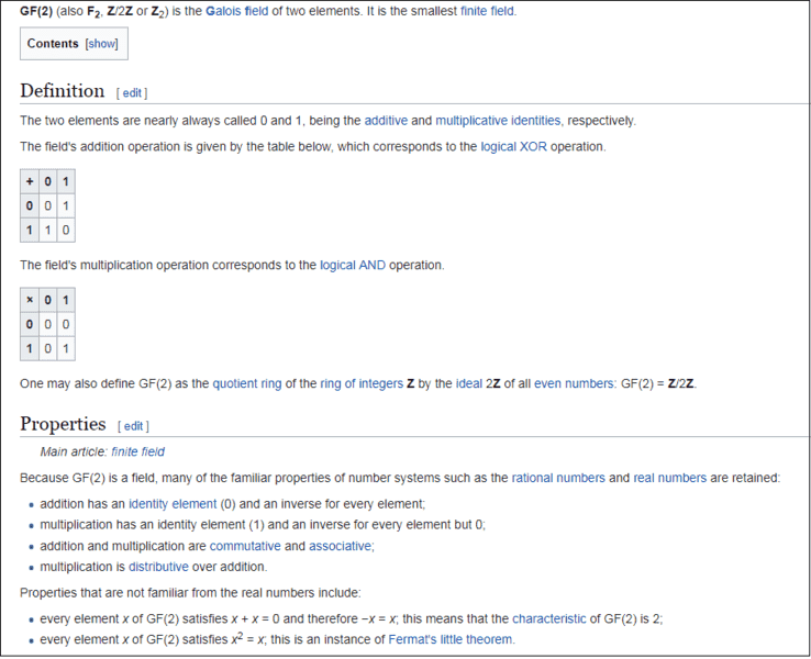

Excerpted from https://en.wikipedia.org/wiki/GF(2):
I recognize that a thing doesn't have to be easy to see for you to be able to see it; however, it's easy, from the Definition section in that excerpt, to see why I would say that XOR is modulo 2 binary addition, and that bitwise multiplication is AND -- I'm in agreement with the abstract algebra mainstream on that.
Even so, that doesn't negate the value of your observation to the effect that we can (by, in your example, using a comparator to obtain the sign bit of twos complement data) take the high and low thirds of a value spectrum and call them +1 and -1 respectively, so we can use multiplication instead of modular addition and produce the same logical result.
However, that requires a three-valued system with the middle value ignored, which is functionally equivalent to using binary modular addition -- i.e. ignoring the zero range in between the +1 and -1 thresholds is viewable as informationally equivalent to discarding the carry.
