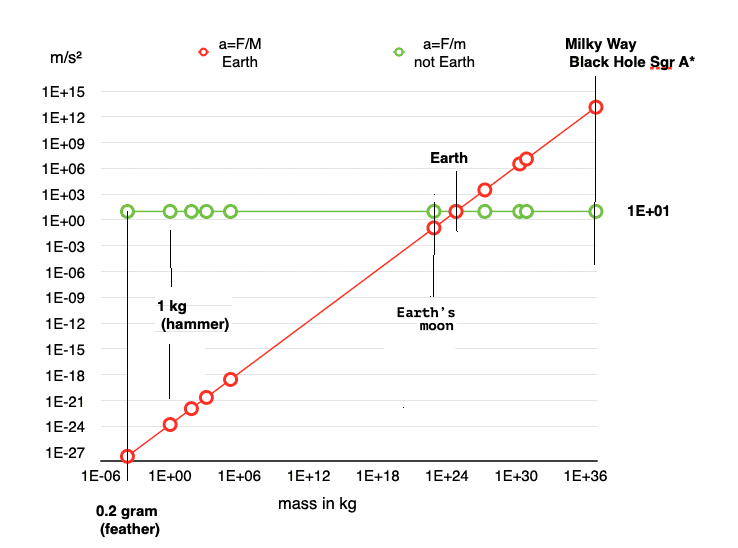

One of the most entertaining facts about the constancy with which things accelerate towards Earth is that no matter how big nor small, it's always the same. (see the green line below)
Even the black hole at the center of our galaxy would accelerate at the same speed as a feather towards Earth.
The only booger is that the Earth would be accelerating towards the black hole quite a bit faster than towards the feather. (the red line)
[edit: minor but obvious error in the graph]
