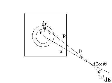

I just want you to chek my solution (just the begining) (math)
You can see the paint.
Coulomb rule
1.
tan(Tetha) = r/a
=> r = a*tan(Tetha)
=> dr = a/cos^2(Tetha)d(Tetha)
2.
dq = Sigma * da = 2Pi*Sigma*rdr =
= 2Pi*Sigma*r*a/cos^2(Tetha)d(Tetha)
3.
cos(Tetha) = a/R
=>1/R^2 = cos^2(Tetha)/a^2
4.
dEy (the enqual) = dE * cos(Tetha)
5.
The limits of the integral are... from Tetha = 0 to Tetha = 90 deg (?)
I ask you... am I right?

Yes, you are correct so far. The next step would be to calculate the integral, using the equations and limits you have provided. The result of the integral will be the field.
