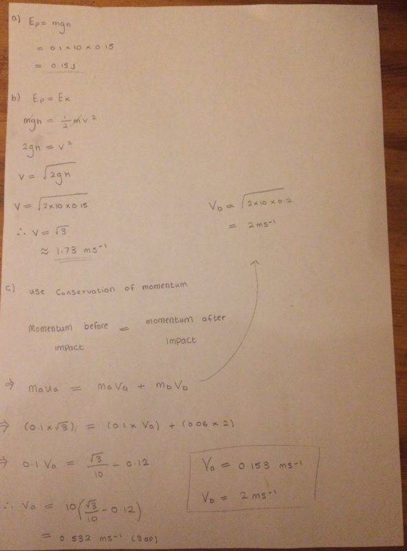

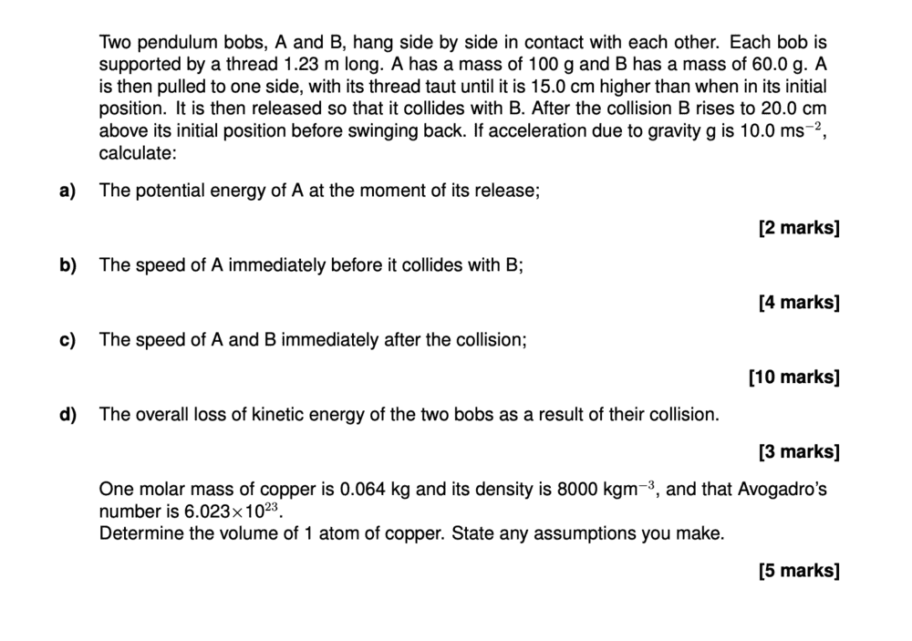

Work out the overall loss in kinetic energy
P=mv
PE = mgh
KE = 1/2mv^2

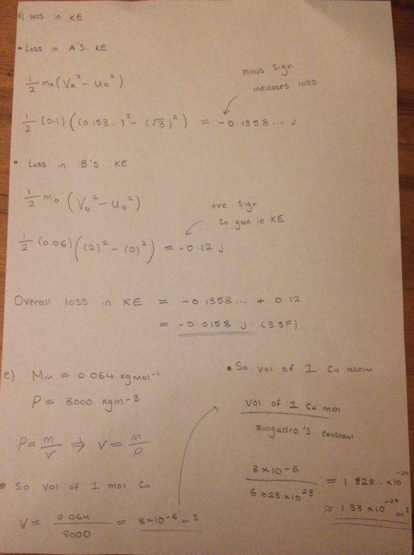

Unsure on whether I have done part d) right for this question
Here is what I have done already:
Any help would be great! Thanks
I didn't understand your calculation in part c. You had 0.532 m/s for A's speed after impact, but it became 0.153 somehow.

Looks okay to me.
What are your assumptions for part e)? Did you try googling for volume of copper atom?
Sorry you are correct. A's speed after impact should have read 0.532 m/s. I don't know why but I misinterpreted it as 0.153 for some apparent reason :headbang:
EDIT: my loss in KE still comes out to be the same as I remember punching in 0.532 m/s onto the calculator.
PeroK said:
Looks okay to me.
I have done a quick google search, and the atomic volume of copper comes out to be '1.182 x 10^-29 m^3' so both values are of the same magnitude roughly. For assumptions, I'm not too certain.
