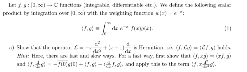

Hi,
unfortunately, I have problems with the following task
I tried the fast way, unfortunately I have problems with it
I have already proved the following properties, ##\bigl< f,xg \bigr>=\bigl< xf,g \bigr>## and ##\bigl< f, \frac{d}{dx}g \bigr>=-\overline{f(0)} g(0)+\bigl< f,g \bigr>-\bigl< \frac{d}{dx}f,g \bigr>## and then proceeded as follows:
$$\bigl< f,\cal L g \bigr>$$
$$\bigl< f,(-x\frac{d^2}{dx^2}+(x-1)\frac{d}{dx})g \bigr>$$
$$\bigl< f,-x \frac{d^2}{dx^2}g+x \frac{d}{dx}g-\frac{d}{dx}g \bigr>$$
$$\bigl< f,-x \frac{d^2}{dx^2}g \bigr>+\bigl< f,x \frac{d}{dx}g \bigr>-\bigl< f,\frac{d}{dx}g \bigr>$$
Then for the last term, I used the above identity ##\bigl< f,\frac{d}{dx}g \bigr>=-\overline{f(0)} g(0)+\bigl< f,g \bigr>-\bigl< \frac{d}{dx}f,g \bigr>## and obtained the following:
$$\bigl< f,-x \frac{d^2}{dx^2}g \bigr>+\bigl< f,x \frac{d}{dx}g \bigr>+\overline{f(0)} g(0)- \bigl< f,g \bigr>+\bigl< \frac{d}{dx}f,g \bigr>$$
Unfortunately now I'm stuck because I don't know what to do with the first two terms, in the hint it says to apply the above identities to ##\bigl< f,-x \frac{d^2}{dx^2}g \bigr>## but unfortunately I don't know how.
Note that ##\frac{d^2}{dx^2} =\frac{d}{dx}\frac{d}{dx}##
For the second term, use the first property to move the ##x## onto ##f##. That is, you can say that
$$\langle f, x\frac{d}{dx}g \rangle = \langle xf, \frac{d}{dx}g\rangle = \langle h, \frac{d}{dx}g\rangle,$$ where ##h(x) = x f(x)##. Use the second property to move the ##d/dx## over onto ##h##. And so on.

First, it's a good idea to write down what you are aiming for:
$$\langle L f,\ g \rangle =- \langle (x\frac{d^2}{dx^2}) f, g \rangle + \langle (x\frac{d}{dx}) f, g \rangle - \langle \frac{d}{dx} f, g \rangle$$Now$$\langle f,\ Lg \rangle =- \langle f, \ (x\frac{d^2}{dx^2})g \rangle + \langle f, \ (x\frac{d}{dx})g \rangle - \langle f, \ \frac{d}{dx}g \rangle$$You need to apply the "##x##" rule to the first and second terms and the ##\frac d {dx}## rule to the third term. Then apply the ##\frac d {dx}## rule twice to the new first term and once to the middle term. And see what you get.
Actually, if you just process the first term, things should cancel out. And things fall out in 5-6 lines.

This is not right. It should be:
$$-\bigl< xf, \frac{d}{dx}g \bigr>+\bigl< \frac{d}{dx}(xf), \frac{d}{dx}g \bigr>$$
Lambda96 said:
$$-\bigl< xf, \frac{d}{dx}g \bigr>+\bigl< x\frac{d}{dx}f, \frac{d}{dx}g \bigr>$$
The reason I introduced the function ##h=xf## earlier was in hopes of you avoiding the mistake you made. In terms of ##h##, you should get
$$-\langle xf, \frac{d}{dx}g' \rangle = -\langle h, \frac{d}{dx}g' \rangle = \overline{h(0)}g'(0) - \langle h,g' \rangle + \langle \frac{d}{dx}h,g'\rangle.$$ Then if you substitute back in ##xf## for ##h##, you'll end up with what @PeroK did in the previous post.

I have now continued the notation with ##h=xf## and got the following.
$$-\bigl< h, \frac{d^2}{dx^2}g \bigr>=-\bigl< h, \frac{d}{dx}g \bigr>+\bigl< \frac{d}{dx}h, \frac{d}{dx}g \bigr>$$
I then substituted ##h=xf## in the second term and applied the product rule
$$=-\bigl< h, \frac{d}{dx}g \bigr>+\bigl< x\frac{d}{dx}f, \frac{d}{dx}g \bigr>+\bigl< f, \frac{d}{dx}g \bigr>$$
I then applied the ##\frac{d}{dx}## rule from the hint again for the second term
$$=-\bigl< h, \frac{d}{dx}g \bigr>+\bigl<x\frac{d}{dx}f,g \bigr>-\bigl<\frac{d}{dx} \bigl(x \frac{d}{dx}f\bigr),g \bigr>+\bigl<f, \frac{d}{dx}g \bigr>$$.
Then applied the product rule for the third term
$$=-\bigl< h, \frac{d}{dx}g \bigr>+\bigl<x\frac{d}{dx}f,g \bigr>-\bigl\langle x \frac{d^2}{dx^2}f,g \bigr\rangle -\bigl\langle \frac{d}{dx} f ,g \bigr\rangle +\bigl< f, \frac{d}{dx}g \bigr>$$
Then I applied ##h=xf## for the first term and applied the x rule from the hint again
$$=-\bigl< f, x\frac{d}{dx}g \bigr>+\bigl<x\frac{d}{dx}f,g \bigr>-\bigl\langle x \frac{d^2}{dx^2}f,g \bigr\rangle -\bigl\langle \frac{d}{dx} f ,g \bigr\rangle +\bigl< f, \frac{d}{dx}g \bigr>$$
If I now add the two unchanged terms to this, I get the following.
$$=-\bigl< f, x\frac{d}{dx}g \bigr>+\bigl<x\frac{d}{dx}f,g \bigr>-\bigl\langle x \frac{d^2}{dx^2}f,g \bigr\rangle -\bigl\langle \frac{d}{dx} f , g \bigr\rangle +\bigl< f, \frac{d}{dx}g \bigr>+\bigl< f,x \frac{d}{dx}g \bigr>-\bigl< f,\frac{d}{dx}g \bigr>$$
$$-\bigl\langle x \frac{d^2}{dx^2}f,g \bigr\rangle+\bigl<x\frac{d}{dx}f,g \bigr>-\bigl\langle \frac{d}{dx} f ,g \bigr\rangle=\bigl\langle \cal L f,x \bigr\rangle$$
