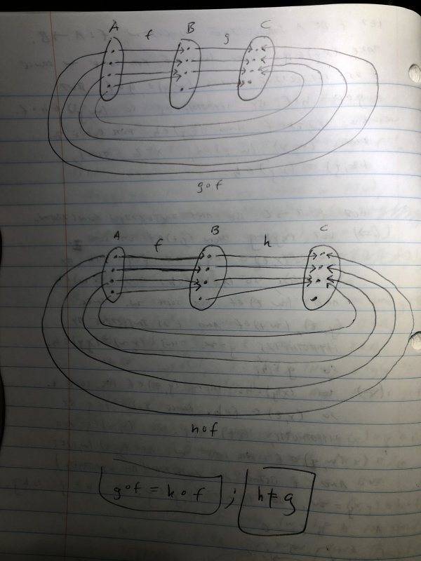

This is a problem in my textbook on set theory, in a section on properties of compositions of functions and inverse functions. The problem is number 5.
Is it just me, or is the statement simply untrue? I have created a simple counterexample that is consistent with the hypotheses, but results in a contradiction of the result. It is included in pictorial form as the second attachment. Any insights?

In your example, for your chosen ##g## and ##h##, does ##g\circ f = h\circ f## for every function ##f##?

In your example you have considered only on function ##f##. The statement is that if it hold for every function, then ##h## and ##g## are equal. In your example there is an ##f## for which the condition is not satisfied.
Likes TeethWhitener
