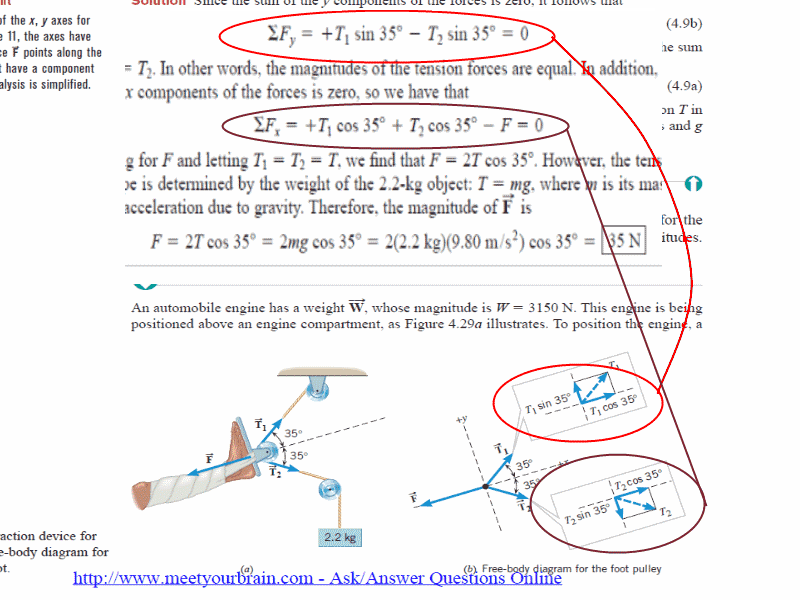

4.9b cites the y components to be sin degree and 4.9a is somehow cos degree for the x components (see picture)

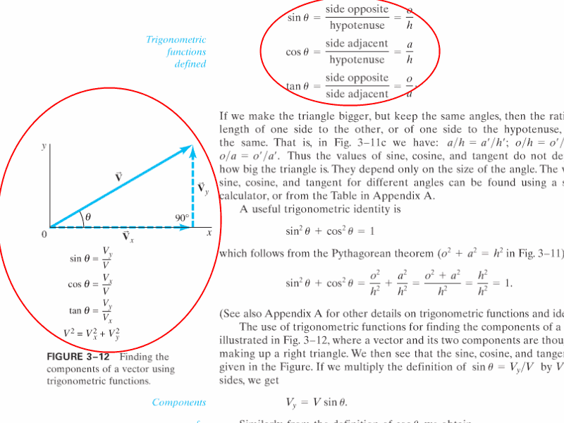

Here's a different textbook that supports my claim (see picture)
Shouldn't the y components for problem 4.9b be cos instead of sin based on how the angle of the vector is oriented? Isn't this vice versa for problem 4.9a (this should be sin)
When splitting a vector V, the y component is V*sinθ, and the x component is V*cosθ. It doesn't matter how the vector is oriented. The picture you posted from another textbook confirms what it shows in the first picture. If you rearrange the sin equation, you get V*sinθ=Vy (which is the y component of vector V)
I just realized that T1 stood for vector V
I thought that T1 somehow was identifying Vector y
