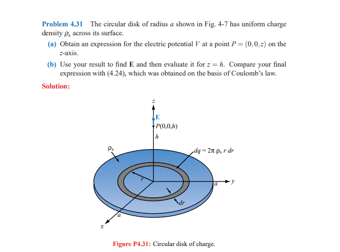

  • V=¼*(1/(π∈) * ∫(ρs/(R')*ds' where R' is distance from point to surface
  • R'=|R-Ri| distance from observation point to location of surface charge density.
So my attempt was to define R' as R'=√((-r)2+(-Φ)2+(z)2). Then I said that ds' is = rdrdΦ. I put this into the integral. I am confused since the integral looks very involved ad wanted to know if my set up was correct.
Any help is much appreciated.

Why do you define R' that way?

Thanks for the response. I am using cylindrical coordinates and since the point P is (0,0,z) and the disk is(r,Φ,0) doing the substraction is -r,-Φ,z whcih is the vector R'. The magnitude is then R'=√((-r)2+(-Φ)2+(z)2).

OK. I see how you did it, but it is not correct. For one thing it is dimensionally inconsistent. It does not make sense to add ##rad^2## to ##m^2##. Let's approach it another way. Let r and z be constant and consider two angles, ##Φ_1 = 0## and ##Φ_2 = π/2##. Is the distance R' different for the different values of ##Φ##?
Well...I guess not mow that I think about it. Since, the distance would be based on r and z, correct?
If this is true, would the surface integral be drdΦ or dΦdz? I think it would be drdΦ since it is defined in radial and angular direction. The surface, I mean.

Yes.

That's close, but what is the differential area in polar coordinates?
