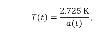

According to the Big Bang model, the CMB photons, unlike lights emitted by objects in space, are photons existed during the early universe and freed during the recombination era. Around t = 0.38 Mly, the photons had a blackbody distribution at a temperature around 3000 K. It is a photon gas, not a photon emitter. Its blackbody temperature changes according to,
where a(t) is the scale factor at cosmological time t. The wavelengths of the CMB photons change with expansion of space,
All CMB photons we observe now have the same light-travel-time to our location (from the same shell in the figure), about 13.8 Gyr - 0.38 Myr = 13.8 Gyr. These photons are the same photons freed during the recombination era, but with wavelengths redshifted by a factor of 1090. The article, Last Scattering Surface, has an interesting analogy to the case discuss here: ‘a large field filled with people screaming’.

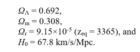

Let’s look at some of the properties of the event horizon using calculation results. We will use the following Planck 2015 data for all the calculations here:
Similar to the results mentioned in Post #1, the CMB photons received by us now were originated from a shell with a radius of R = 41.57 Mly at t = 0.372 Myr during the recombination era and the event horizon had a radius of 56.72 Mly at the time. According to Rindler (1956), Visual Horizons in World Models, the CMB photons originated outside the event horizon will never reach our location. This is because those photons are carried away from our location due to space expansion in the Big Bang model.

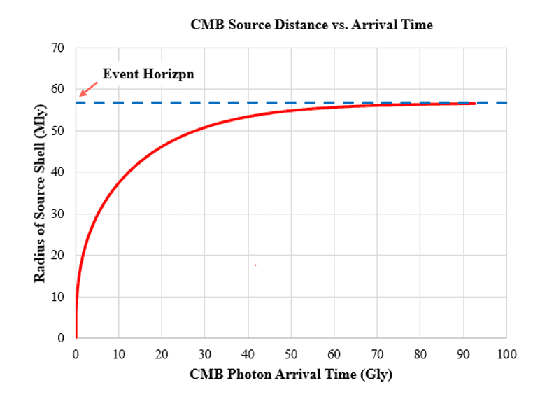

How about the CMB photons originated inside of and close to the event horizon? They should be seriously affected by the space expansion too. We may ask: When do the CMB photons, for example, originated in the shell of radius of 30 Mly, 50 Mly, or 56.55 Mly arrive at our location? The arrival times can be calculated with the calculator post by Gnedin or that by Jorrie using the equations posted by Bandersnatch in his thread, Distances between observers using the Lightone7 calculator. The calculation results are summarized here.
The following shows the relation between the radius of the shell in which the CMB photons were originated and the arrival time of these photons to our location:
The figure below shows the graphic form of these results:
Here are some observations from the above results:
  • All CMB photons reaching our location are originated in shells inside the event horizon, consistent with the statement that no photons outside the event horizon at t = 0.372 Mly will reach our location.
  • Journeys of the CMB photons inside of and close to the event horizon during the recombination era have prolonged journeys to reach our location. For example, R = 41.57 Mly, t = 13.8 Gyr; R = 50 Mly, t = 27.62 Gyr; and R = 56.55 Mly, t = 90.15 Gyr.
  • These results indicate that the supply of the observable CMB radiation is limited in the ΛCDM (Big Bang) model due to space expansion.
  • The supply of the observable CMB radiation, however, does not end abruptly. It is a dwindling process; when the radius of the source shell getting closer and closer to the event horizon, the available CMB photons become less and less (see figure).

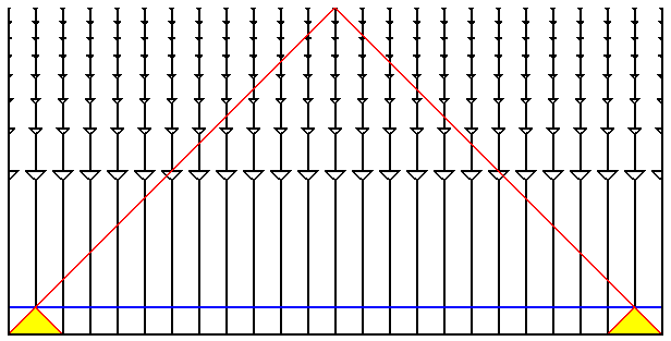

In the standard BB model, the scale factor (i.e. 'space') being smaller at recombination (or any other early moment) doesn't help, as the size of the past light cones at that time was also smaller. It is generally true of the expanding universe that the further back you go, the less of the 'contents' of the universe you are in causal contact with.
On the conformal diagram, it looks like this (taken from Ned Wright's tutorial):
The large red triangle being the current light cone extending into the past. I.e. it's all the events that we currently observe. The extent of it's base marks the furthest comoving regions we are in causal contact with. The blue line marks some early event (such as recombination). The yellow triangles mark all the events that were in causal contact with what we observe of that event. If you were to push the blue line even further down into the past, the yellow triangles would shrink even further. The two triangles are not overlapping, so they couldn't have exchanged any information with each other.
So, observing two opposite regions of the sky, we see the CMB as thermalised, even though there was no way for them to 'know' what temperature they should equalize to.

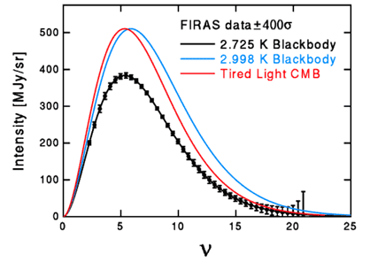

In their 2015 paper, Remaining Problems in Interpretation of the Cosmic Microwave Background, Fahr and Sokaliwska mathematically demonstrate that assuming the CMB to be a blackbody photon gas at recombination, it will remain so over time under cosmological redshift and homogeneous expansion of space, i.e.,
Starting from a blackbody CMB, (the cosmological redshift) + (change of CMB photon density due to space expansion) can maintain the blackbody nature of the CMB.​
The calculation results presented in this thread suggest that the observable CMB photon density, besides being diluted by the expansion of space, can also be affected by the existence of the event horizon that causes the dwindling supply of the observable CMB photons. This affects the mathematical derivation given by Fahr and Sokaliwska and implies,

The 2015 paper you reference correctly states that a blackbody remains a blackbody when it is redshifted; but that is actually a general result that does not depend on the specific nature of the redshift.
You seem to say that redshift alone preserves the blackbody distribution. That is untrue. As I said,
See Wright’s Errors in Tired Light Cosmology for a demonstration.
No, it is true.
Nothing on that page has anything to do with either the erroneous claims you are making or my correct responses.
Do you have any reference that actually supports your claim that the presence of an event horizon is inconsistent with the CMB being a black body? Either provide such a reference or this thread will be closed.
