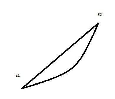

PAllen said:
Which part of the legs of the triangle are 'extra' compared to the hypotenuse? If you want to say all are, that's ok, I guess, but I would view it as meaningless. Equivalent to asking which part of a quart of water is 'extra' compared to a pint of water.
I tried to understand what you say here.
I attached a small diagram, could you describe what is exactly meaningless?
The curved line is the accelerating one while the straight line is the geodesic.
What is meaningless to claim that some part of the non-inertial path is what is responsible for the less aging. What is responsible is that it isn't inertial. Along the path, a second is a second, no part is more responsible than any other except by some arbitrary convention.
The analogy to a triangle is to ask which part of the legs is extra. It can't be answered. The legs are longer because the path isn't straight. There is no meaningful way to say the some part of the legs are extra.
The differential aging depends on the total diversion from the geodesic path.
If three people go from event E1 to E2 and one goes inertially, one accelerates a little bit and the third one accelerates the most than it is always true that the third one ages less.
How are you quantifying accelerating a little vs. accelerating more? For example, B and C could both move inertially away from A at the same time, then B could accelerate back toward A earlier, then accelerate in the opposite direction when it got close to A so it was at rest with respect to A at some finite distance apart. Meanwhile C could accelerate later, turn back towards A, and then when C got close to A again B could accelerate a third time, so that both B and C met A at the same time. In this case, since B spent a lot of the time at rest relative to A, B would have aged less than A but more than C, but in this scenario it seems to me that B "accelerated more", especially since we could imagine that the magnitude and period of B's acceleration during all three acceleration phases was the same as the magnitude and period of C's single acceleration.
I completely agree. This whole discussion goes back back to a some earlier posts (not by you) that claimed there was some meaningful way to identify which parts of the paths from E1 to E2 were responsible for the aging differences. Specifically, the period of acceleration or the coasting after acceleration were suggested. I claim this is meaningless. The total deviation from geodesic from E1 to E2 is the only thing that is meaningful. There is no meaning to saying it is because of the accelerated part or the 'second half' of the path rather than the first part of the path.

What I said applies to this scenario and any scenario. Imagine you draw two lines on a plane between the two points. One line is longer than the other. It happens that there are some curves and segments between them that are similar. It is not meaningful in any way to say that the dissimilar parts are responsible for the extra length. Or, I have two containers of water, one bigger. The bigger one has a section the same shape as the smaller one. Is it meaningful to say the the water in the other part is the extra water, and is more responsible for the extra volume than the other water?
In your case, the only statement that has meaning is that one path has a greater total deviation from the geodesic path. All parts of the path contribute to the aging, and it is truly meaningless to single out particular sections as responsible for the smaller aging. Every part of the path contributes additively to the aging.

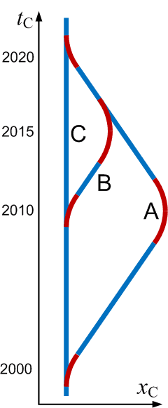

Here's a nice spacetime diagram DrGreg once posted--if we flip it over vertically so the worldlines of A and B coincide when they initially depart rather when they finally return to meet C, would it match the variant you're talking about? You can see in this diagram that both A and B have identical accelerations, just at different times:
