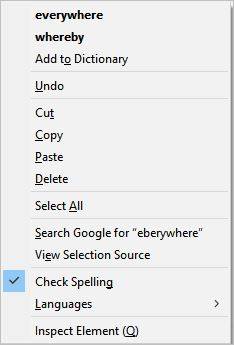

Here's a little trick though, see the red squiggly line under eberywhere ?
And, see the the check mark in the dropdown ?... put a check mark at the same place in yours...

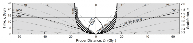

  • #32
alexopth1512 said:
since the "universe" is expanding and we have an "horizon" where the relevant speed reaches the speed of the light
The cosmic event horizon is not coincident with the Hubble sphere. These two are the same only in universes devoid of matter and radiation, with dark energy component only (so called de Sitter universes).
In a universe like ours, the expansion rate falls down with time, allowing signals from beyond the Hubble sphere to reach us in finite time.
Notice how the Hs and EH tend to converge to a common value reflecting the universe becoming incereasingly dark energy-dominated.
(Graph source)
