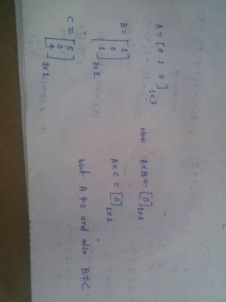

True or False, if AxB = AxC then either A=0 or B=C.
A, B, and C are vectors and I thought this statement would be true. However the answer key says it is not. Why?
This can be explained by following example
Ok that makes sense. Now if the the magnitude of the cross product was not zero then B would have to equal C Right?
The magnitude of AxB is equal to the magnitude of A times the magnitude of B times the sine of the angle between the vectors A and B. If the magnitude of C is larger than the magnitude of B, but the sine of the angle between A and C is less, AxC can be equal to AxB.
Not at all. All that AxB=AxC says is that either A=0 (in which case any two vectors B and C satisfy AxB=AxC), or that the components of B and C normal to A are equal.
Or that since AxB=AxC is the same as AxB-AxC=Ax(B-C)=0 then A and B-C are parallel.
