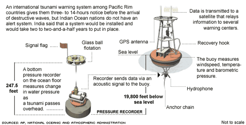

I tried to find a graphic that illustrates @davenn 's correct answer. I found this. It's pretty extreme, but the principle applies to all waves, big and small.

But the tsunami wave is wide enough that an ocean floor monitor can pick it up? That might make sense.
Yes. Tsunami waves have huge wavelengths, huge enough that the ocean depth is smaller than the wavelength. Accordingly, they qualify as shallow water waves.
