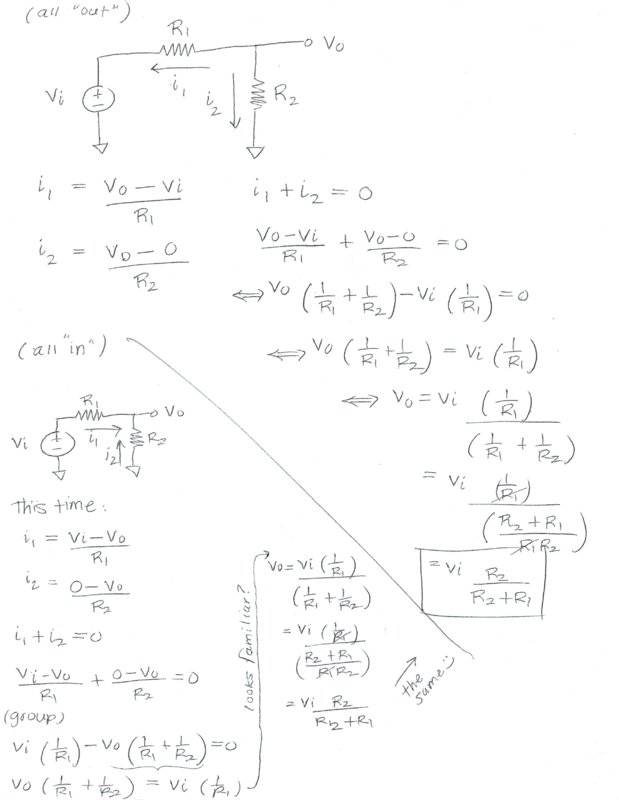

My personal preference is to make them all face the same direction ie. all inward or all outward. I don't have to worry about any bookkeeping and I'll let the mathematics dictate the direction.
Something like this:
242225
Here's an example with a classic Voltage Divider. I know it's simple, but the point is to show that the direction didn't matter.
242226
Likes sysprog and Tom.G
