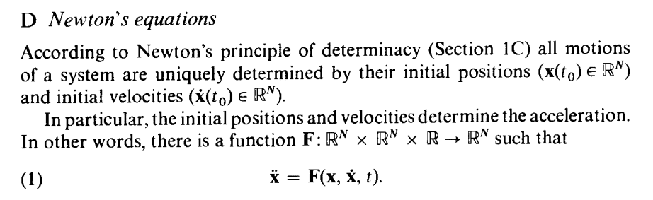

For example in Arnold's "Math methods of classical mechanics" we read
then how can a function of ##x,\dot x,t## be identically equal to ##m\ddot x## as it jbriggs444 claims?
That is way I say that questions like "what is force by definition?" need accuracy.
You missed the part where you defined what force is. If you do not define it otherwise then a definition in terms of mass and the second derivative of position is as good as any other.
I prefer to think that we choose the function ##F(t,x,\dot x)## such that the solution of the differential equation ##m\ddot x=F(t,x,\dot x)## would have been consistent with the result of experiment. If ##ma## is a definition of the force then the 2nd Newton law is just a tautology and gives nothing.
