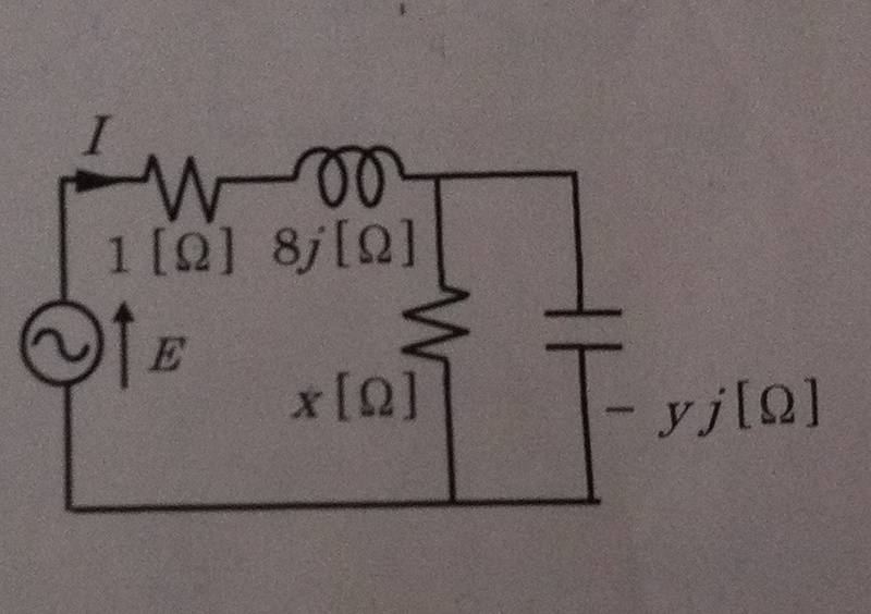

Is there any other easier way to get the answer for no. 2?
Power supply voltage E=8+4j [V]; Current I=1-j [A].
1) Find the power factor of the circuit as seen from the power supply.
2)Find the values of x and y.

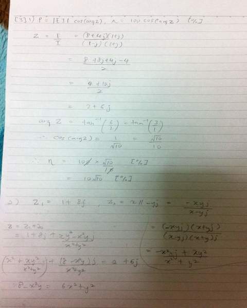

There's a little mistake at the very last part of my working, but anyways, I want to know if there is an easier way.

I can't think of a distinctly easier method. You have two unknowns so you have to come up with two equations. Equating the terms of the known impedance to those of the expression for the impedance seems logical. After that you bring to bear any algebra tricks you've learned. (hint: consider forging a new expression by taking the ratio of the terms)

Looking at your work, I don't clearly see the two separate equations as such. Can you write them out?
I got it! There was a lot of miscalculations before. I got x=5, y=5/2. Correct?
Your result looks fine.

Yes, there is an easier way.
Once you’ve divided the complex source voltage by the complex current, and subtracted the (1+j8) you have the series equivalent of the other components. This type of calculations go back and forth between series and parallel configurations, so it is a good idea to develop formulas or even functions you can use for those conversions over and over again.
Instead of using the method taught in class to multiply and divide complex numbers by converting back and forth from rectangular to polar, here is a short cut.
The series value of Xs and Ys is 1-j2.
Xp = (Xs^2 + Ys^2)/Xs = (1^2 +(- J2^2))/1 = 5
Yp = (Xs^2 + Ys^2)/Ys = (1^2 +(- J2^2))/-j2 = -j2.5
This shows the answer you arrived at for Yp should be –j2.5 instead of +j2.5.

WOW!I didn't see that earlier. That is definitely a shortcut. By the way, in the diagram it already shows the negative sign with y, so all we need is the y value, without the negative sign. But I don't understand this part:
