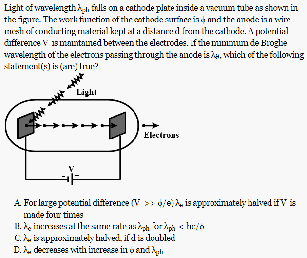

Kinetic Energy of an electron is given by $$\frac{hc}{\lambda_{ph}}-\phi+eV$$
Does ##V>>>\frac{\phi}{e}## mean that kinectic energy is approximately ##eV##?
NA
So there was this question:
The first option seems to be the only correct answer.
$$\lambda_e=\dfrac{h}{\sqrt{2m(KE)}}$$. The answer would be correct if ##KE \approx eV##
The option mentions that ##eV>>\phi## so ##\phi## can be ignored.
But I don't think that necessarily means that the energy of photon can be ignored?
So I looked it up and this seems to conclude that there is no limit on energy of photon. This would mean that the option 1 will be correct only if ##eV>>\dfrac{hc}{\lambda_{ph}}## (which is not specified so incorrect.) Can we reasonably assume that for most practical purposes, the energy of photon is of same order as work function(##\phi##)?

The question specifically refers to light which has photon energies in the range 1.6eV to 3.3eV approx.
Note, ‘eV’ (electron-volt) is an energy unit, not to be confused with the ‘##eV##’ in your equations. To avoid confusion I’ll use ##V_a## to represent the accelerating voltage.
The electron’s final energy (##K##) will be the sum of:
- the photon energy (a few eV);
- minus the work function (typically a few eV);
- the energy gained due to the accelerating voltage (##eV_a##).
Clearly if ##V_a## is large enough, ##K## is nearly equal to ##eV_a## because the other terms will be negligible.
However, it would have been better if the question had said ##V \gg \frac 1e (\frac {hc}{\lambda_{ph}}-\phi)##.

Shouldn't that mean maximum kinetic energy therefore as high as possible value of photon energy?

Is there a limit to the energy of a photon if we are free to change to an arbitrary frame of reference?
No. There is no such limit. We can pick a frame moving arbitrarily close to the speed of light (relative to some initial frame).

So is there a limit if the frame of reference is fixed?
If we select co-moving coordinates then the total energy in the observable universe is an upper bound on photon energy. Not a particularly tight bound -- the ability to collect that energy into a single photon would pose a significant engineering challenge.

I'd agree. The term 'light' is typically applied to IR, visible light , UV and (sometimes) X-rays.
But from the nature of the question, it would be reasonable to assume that 'light' refers to visible light, 'near UV' and possibly 'near IR'. I'm sure that's' what the author of the question intended.
Note that for sufficiently high energy photons, the photoelectric effect would be insignificant. Other processes (notably Compton scattering and pair-production) would occur. This is outside the scope of the question.
