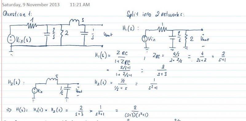

Is there a problem with this Source Transformation?

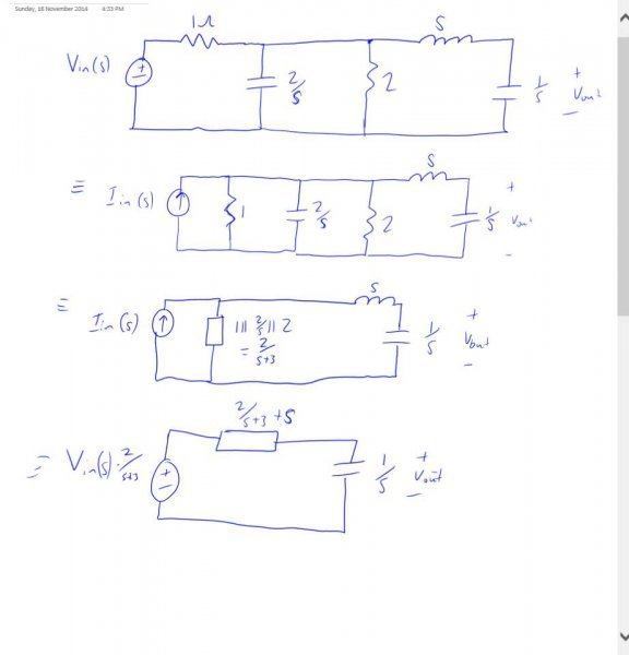

Hey guys, i did this source transformation as an alternate method to find the transfer function of a circuit, however I am getting a different transfer function of 2/(2s+(s+3)(s^2+1)) to the solution in the following image. Any help would be really appreciated :)
Hi danie9! http://img96.imageshack.us/img96/5725/red5e5etimes5e5e45e5e25.gif
Your analysis using the first method looks right.
The mistake you're making in the second is that while representing the first stage by its Thévenin voltage source you are forgetting about its Thévenin impedance. The result is as though there exists a unity gain buffer amplifier between the two stages because you are, in effect, assuming/using a Thévenin impedance of zero ohms. But there is no such isolating amplifier. So as well as redrawing with a voltage source you need to include the impedance of that voltage source to properly account for the loading effect of stage II on stage I.

Yes thank you so much, i will definitely start using a cursive 's' :)
